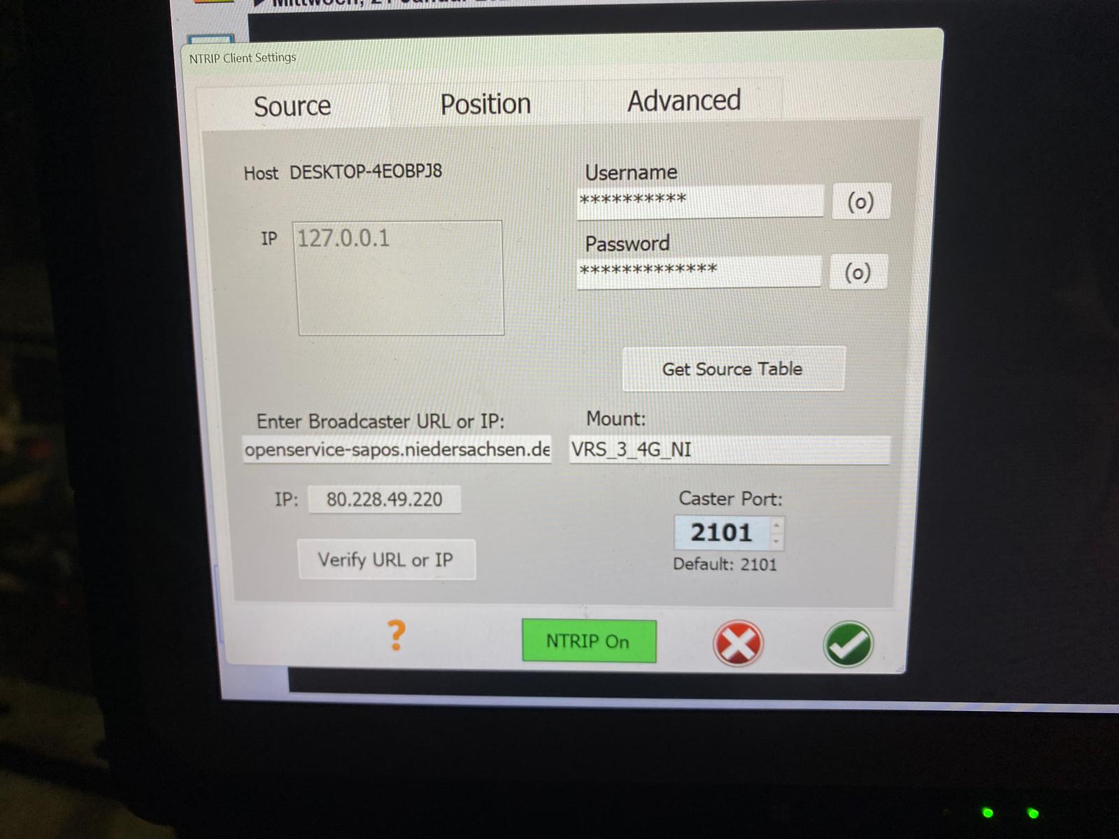

Here in Germany we can get the rtk signal for free you just have to sign up on the sapos platform. For me it’s “Niedersachsen”. So ive got my User Name and password, typed it in but some how it won’t work.

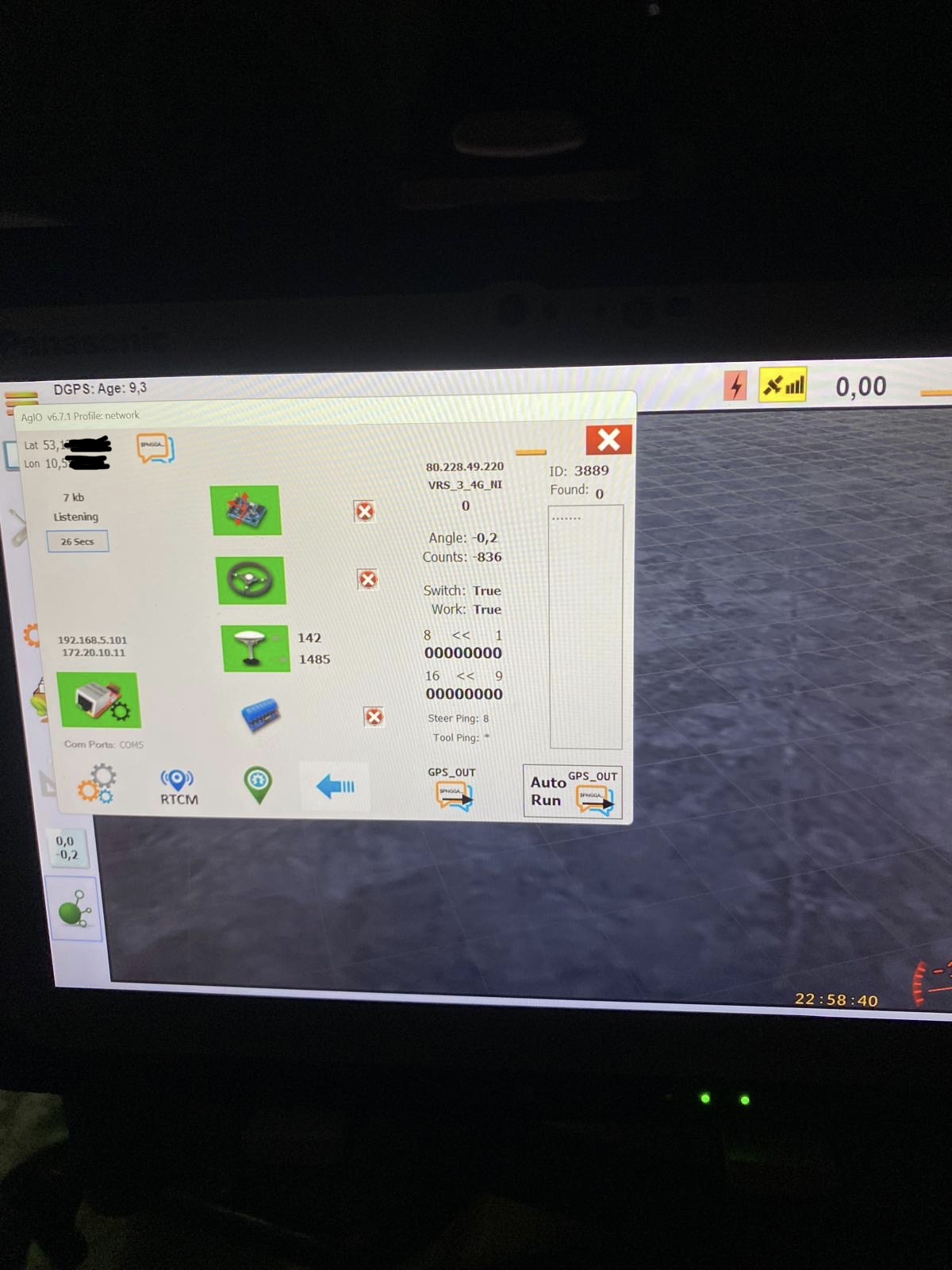

Here are some fotos of my settings.
I saw on videos on YouTube that I should get on the right side some data but it doesn’t show me anything, just some dots.

It looks like your possibly connected but your just too far away.
In the ntrip settings press the source table to see how far from the base station you are trying to connect to
Do you have hotspot or Internet in the tablet?
When you fill in the ip details do you get the 'ip verified ’ message?

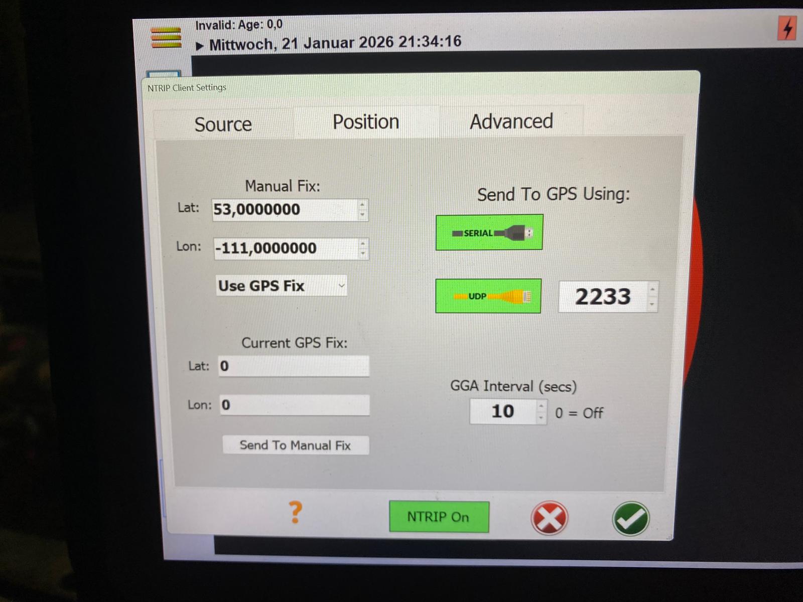

I am quite sure only one of either USB/serial or UDP should be Green. Try select the one you use and save/ restart rtcm
This could also be a virtual base in which case it would be important to have the current location right, either manual or GPS based (neither seem OK at the moment).
Or your IP out to internet is not the same as autosteer.
I see your RTCM is listening but probably not ever sending GGA (mine shifts between the two, and kb is constantly increasing) I dont even have a autosteer board connected!

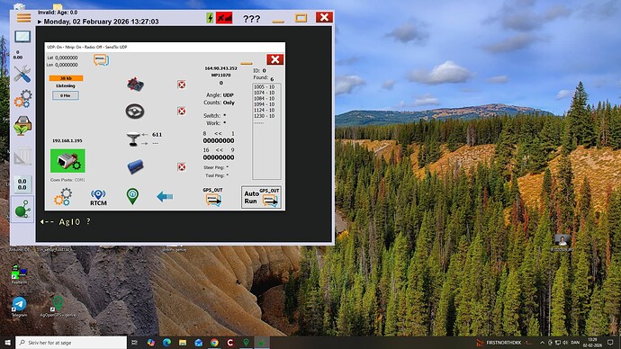

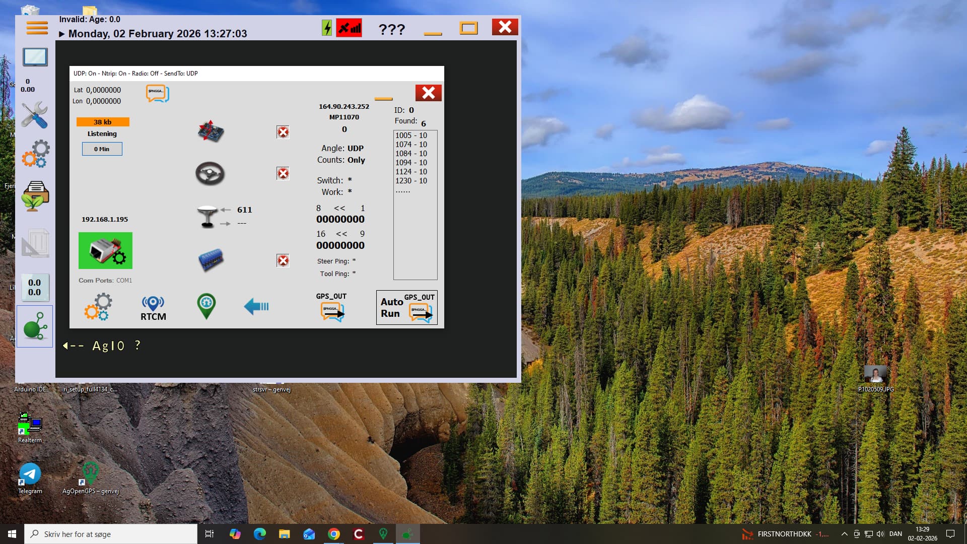

Prt scr from my computer connected to a caster.
