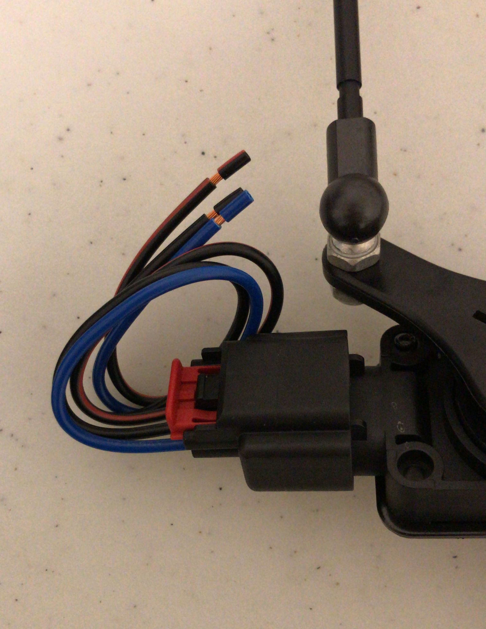

These ones work. But I didn’t recieved my 2 last orders from this seller
The gray connector from this seller maybe work without having to cut the 2 tabs on the sensor.

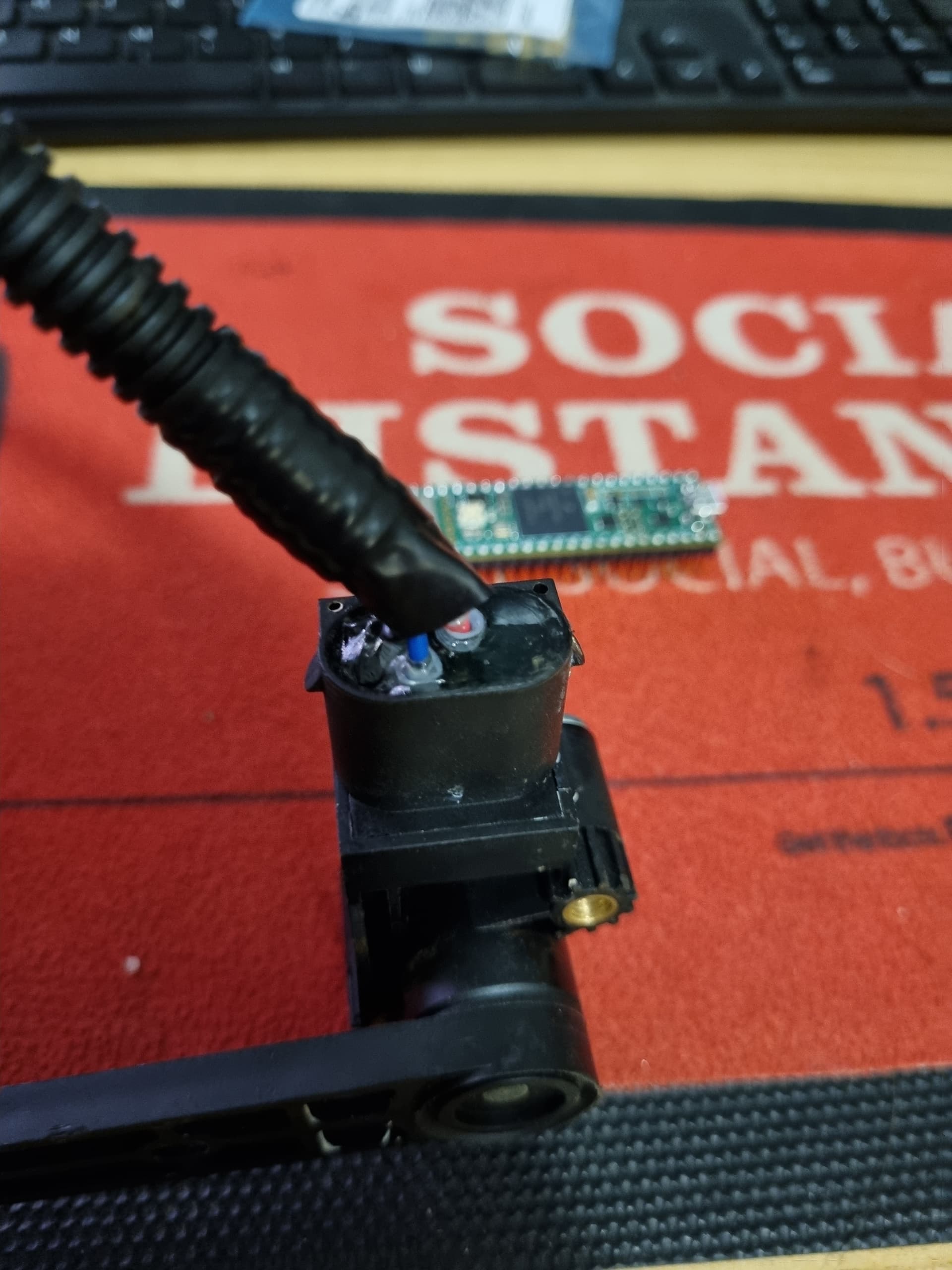

After encountering the same problem with an ebay spec landrover type WAS, i ended up just finding some pins that fitted over the pins, and then potted it with a 2 part epoxy and have a 3 pin deutsch plug (I buy them in 20 packs online) so I had a more common, serviceable plug. I figured it was a better solution than using a weird OEM connector just used on one part where as I use deutsch plugs as the main type of plug on my wiring harness.
I found a connector that worked at Canadian Tire.
It is also available on Amazon.ca
That is significantly cheaper than the land rover option, has anyone compared the sweep on it to see if it has the same level of senstivity? I like teh ball joint connection as well, as that looks more robust.
It’s ultra precise and repeatable, no problem at all.
