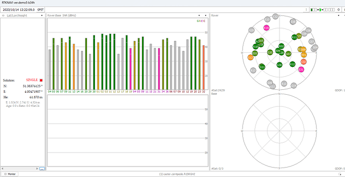

What is your mount point on the centipede caster ? I will check the rtcm stream.
It is: DRGHZ
Everything seems ok with the centipede caster. As the source is the same for all the ntrip service, rtk2go should be ok too.
Thank you for checking, might try to make a new mountpoint with rtk2go, or stick with centipede which usually works fine for me.
