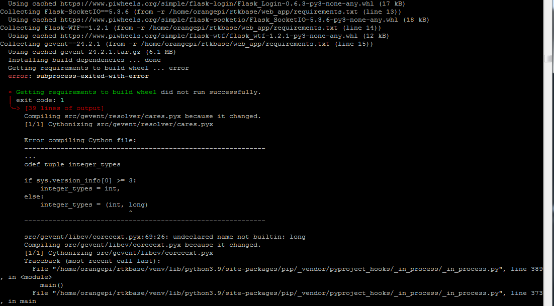

hello, did you install rtkbase recently?
yesterday and today I have the same problem installing RTKbase, the installation is going well but it won’t start. I did it sometime in March like I did now and it went away.
now I look back at the log and I found something that I don’t think is right, and that’s why it won’t start? or what could be the problem Debian 11 Orangepi
Failed to stop systemd-timesyncd.servie: Unit systemd-timesyncd.service not loaded.
Failed to disable unit: Unit file systemd-timesyncd.service does not exist.
You can ignore these message. The installation want to disable timesyncd, but it’s not installed → no problem
then I don’t know what the problem could be
 the installation goes to the end and at the end it says
“END OF INSTALATION
You can open your browser to http://192.168.1.72”
but rtkbase doesn’t run
Could Debian 11 be old?
Update: I found an error with the installer, could this be the problem?
Yes!
Debian 11 is old now. Try with Debian 12.
I know it won’t work with Debian 13 until the next release.

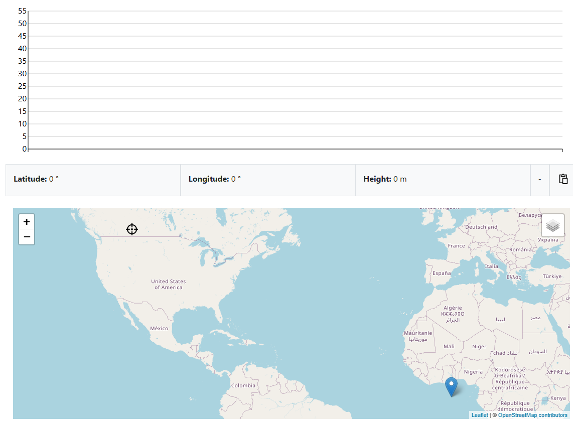

Anyone know why I’m suddenly not getting any satellite data today? Rebooted many times. How would I go about testing the F9P isn’t bricked? Has been flawless for idk 3-4 years
Update: Replaced F9P board with a spare, no change. Replaced antenna on roof - works! Wild, never would have expected a basic antenna to fail.
Hello Stefal, I had time to play a little, this is all a hobby, yes I installed Debian 12, started your RtkBase script and now it doesn’t get stuck with the python installation.
It can’t work on Debian 11 anymore.
With Debian 12, rtkBase starts but there is a bug in systemd-timesyncd which may not be a bug. Could this cause a problem with RtkBase?
Failed to stop systemd-timesyncd.service: Unit systemd-timesyncd.service not loaded.

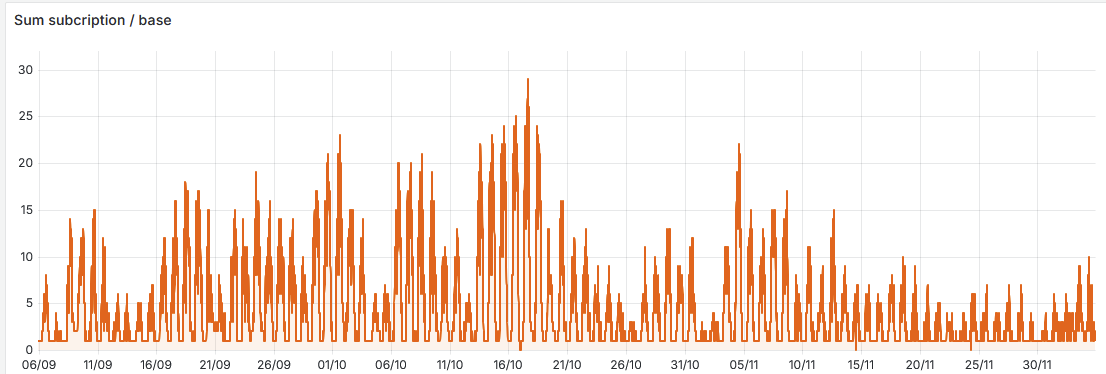

Hi all! I’ve build my own RTK station following this thread and it’s working just fine! I was just wondering is there any way to see if someone is using my RTK base? Just out of curiosity, it would be very cool to see it being used by farmers in de area.
on my phone on rtk.data i can see if theres other rovers using mine
What caster are you using, for example emlid shows you how many rovers are connected at the moment
If you send your stream to a caster, the base station can’t know how many rovers are using it. Only the caster can know it. If you use the Centipede-RTK caster, it’s available.
