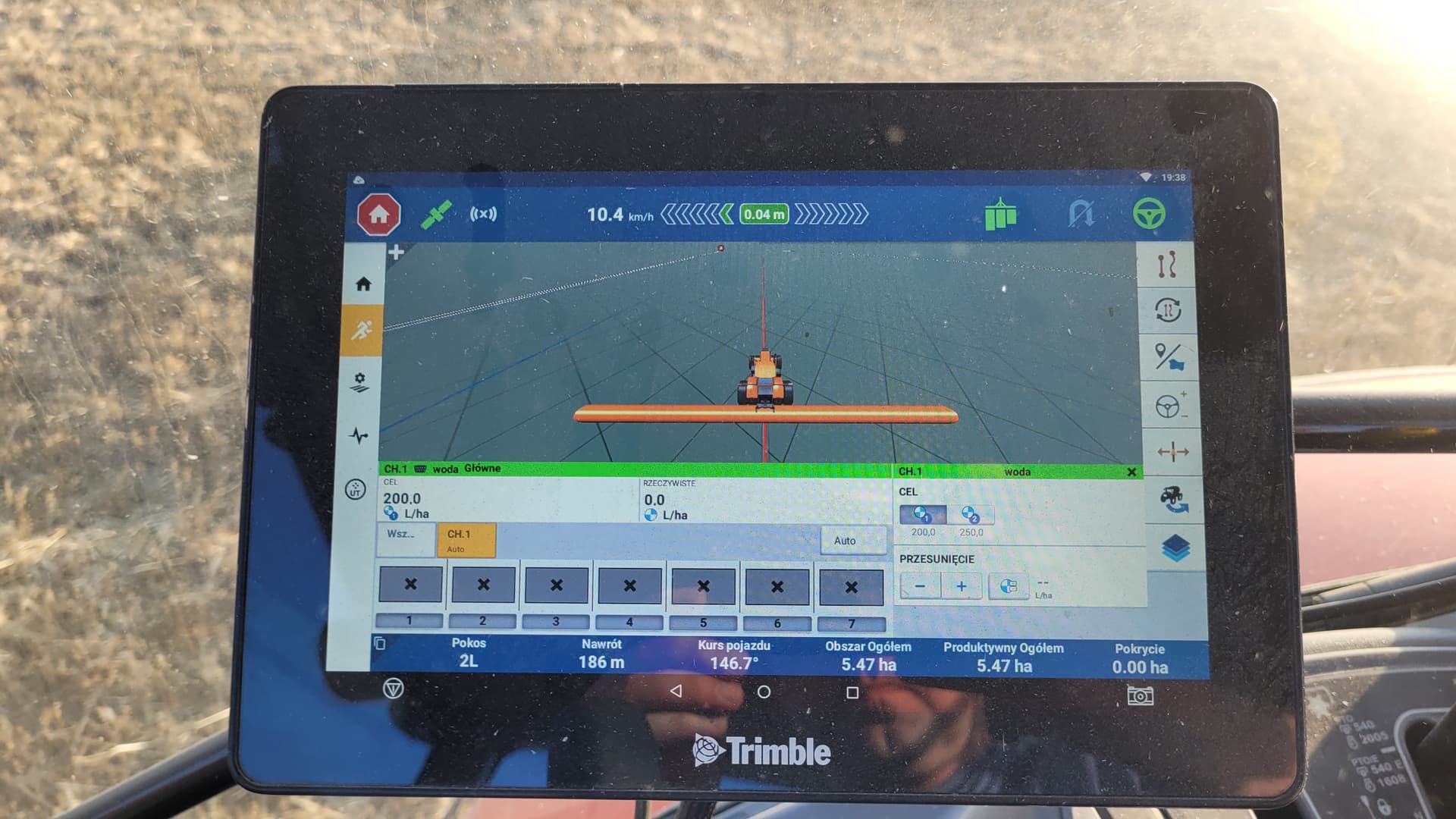

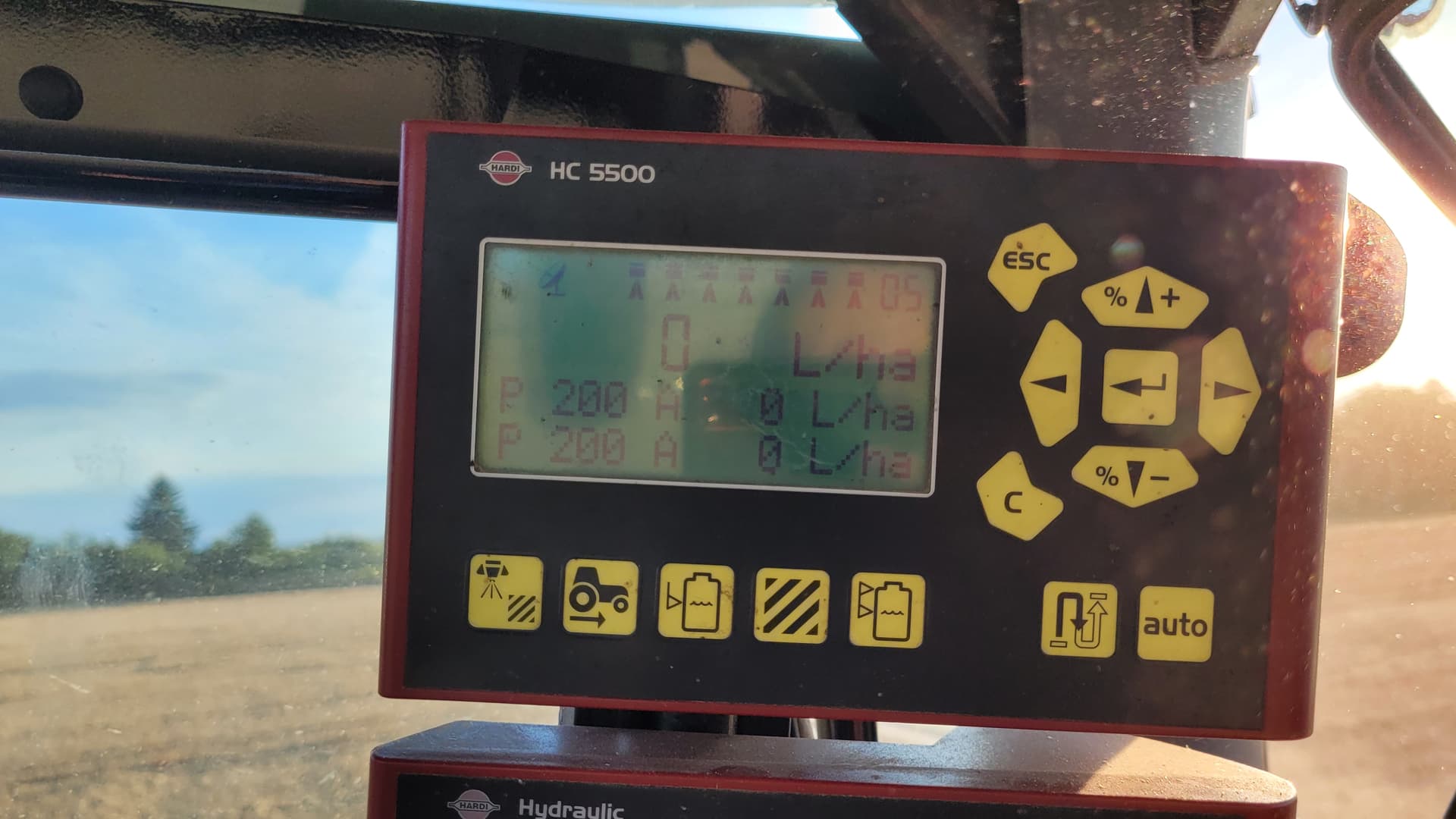

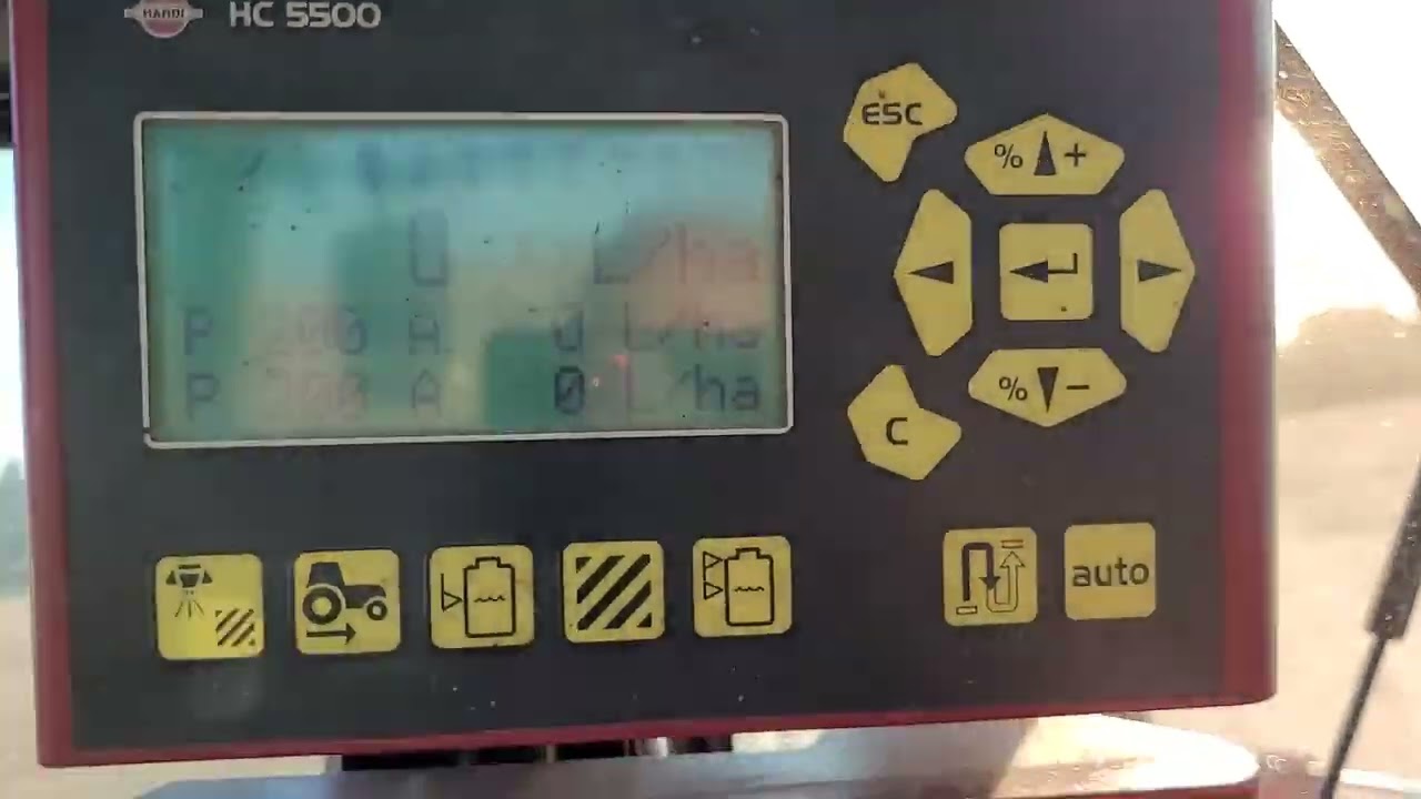

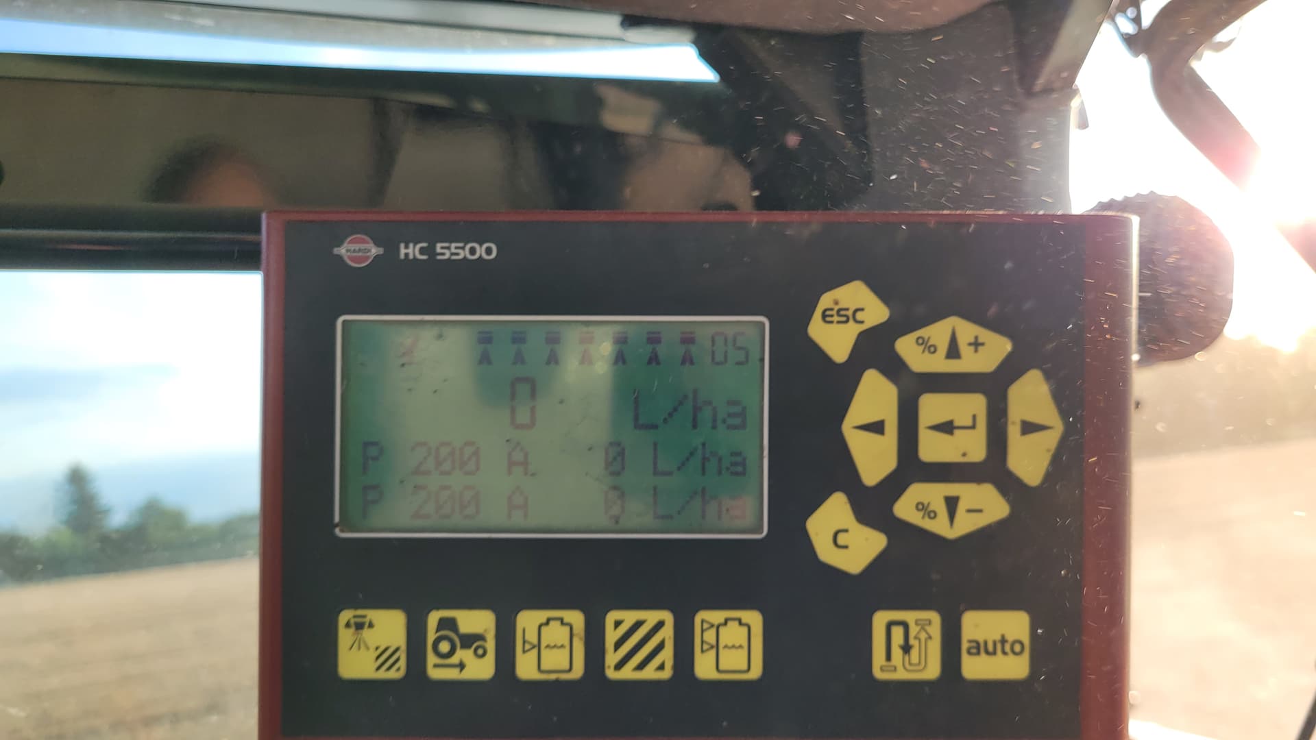

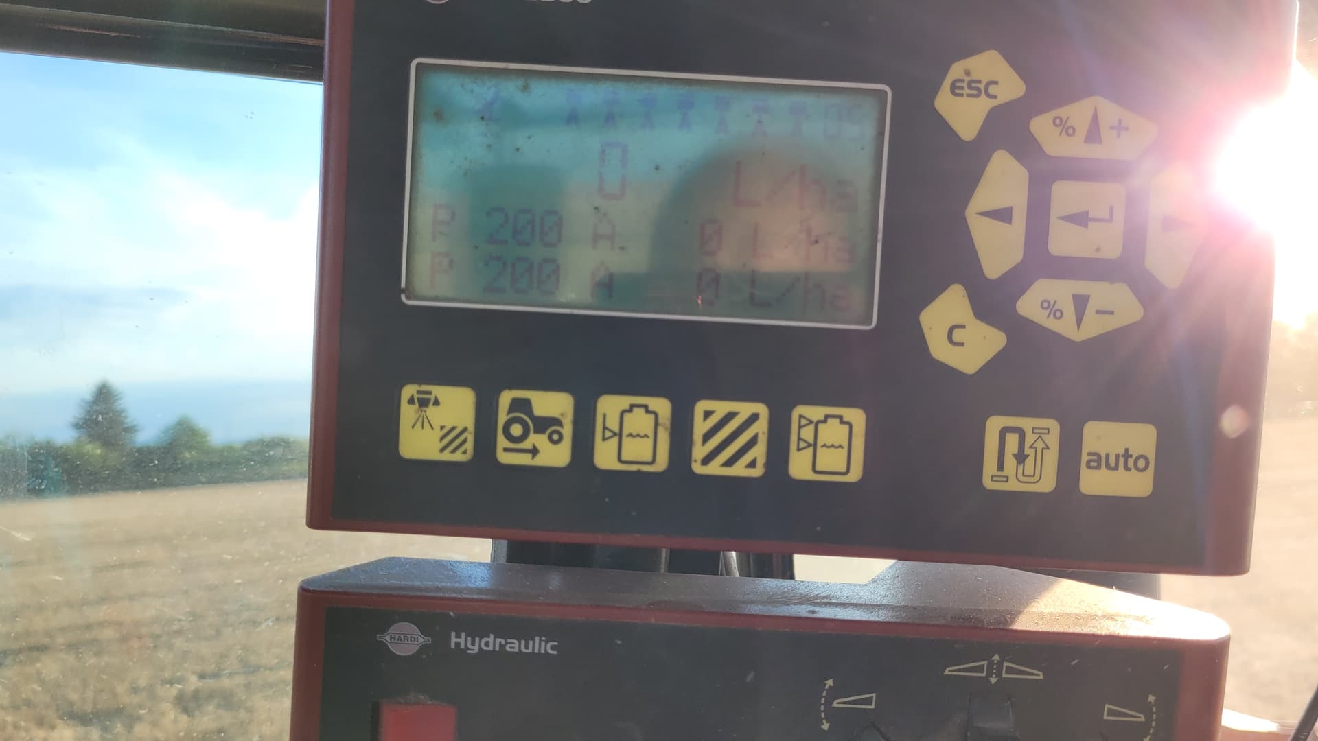

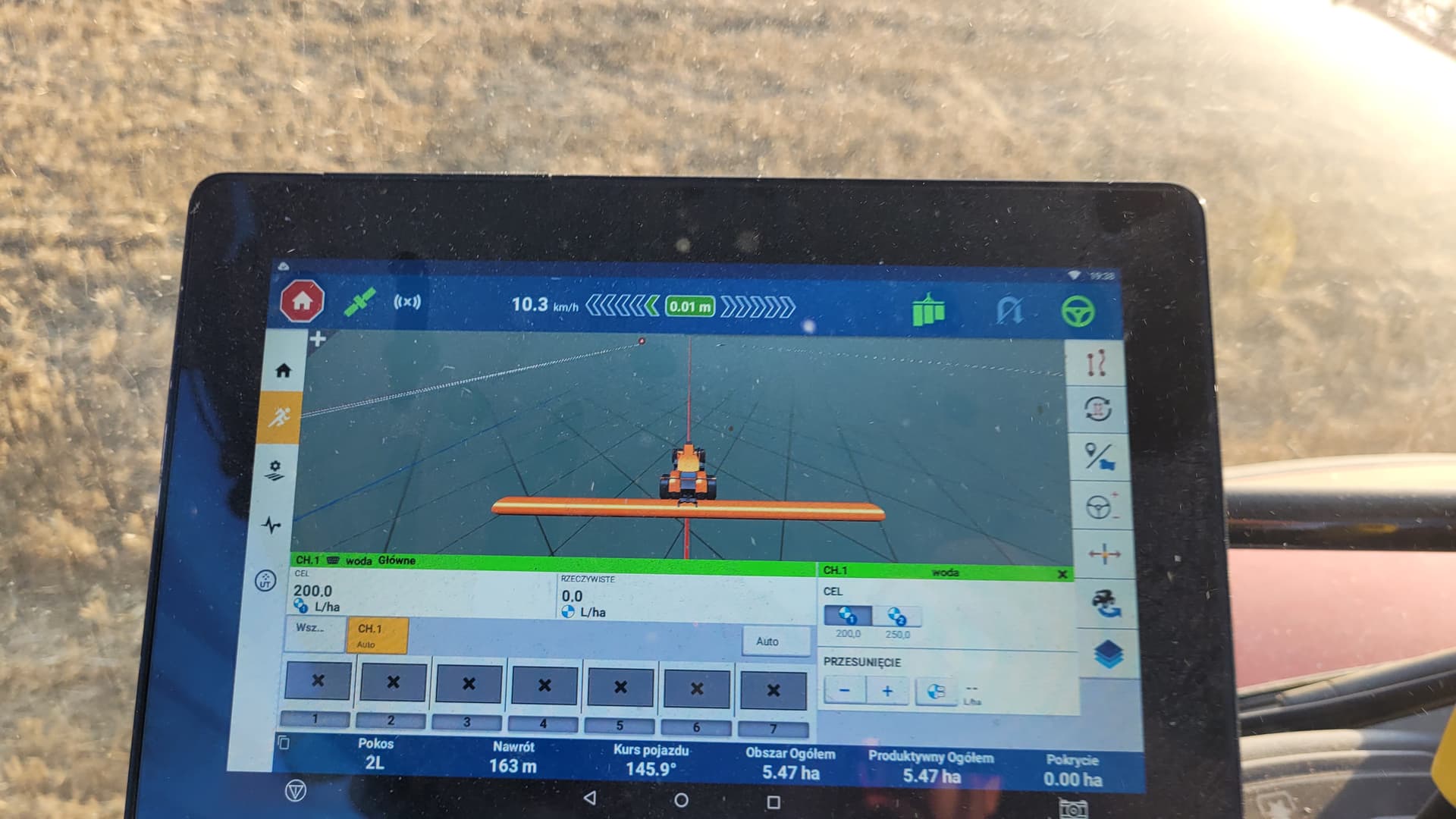

@WildBuckwheat is that ok that i do not see the actual rate
I believe I had a separate setting somewhere that allowed my 750 to display and set the rate, but I kept that setting off.
I have both section and rate setting on. It seems hardi do not see speed
I believe that in your HC5500 there is a setting that decides whether speed comes from the gps or from the wheel sensor? I think you have a 3pt machine which doesn’t have a wheel sensor, maybe the setting is not set correctly?
I do not see any option for speed sensor. Maybe VRA ENABLE, disable (disappear) option for speed
