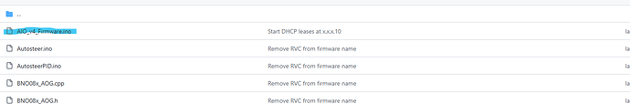

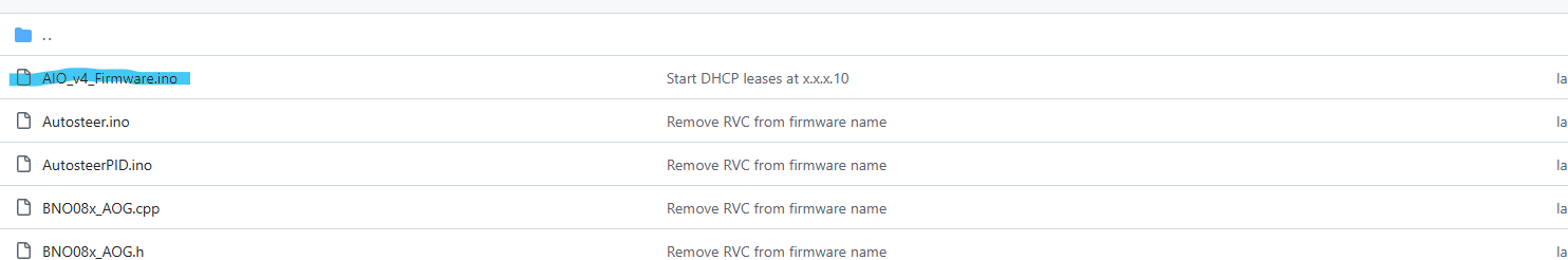

Is it this file?
And this section that needs updating?
BAUD RATE

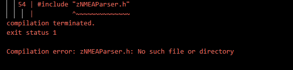

When I try to compile it in Aurdunio IdE, I get this error.
What gps module you using? Could the configuration be changed to 460800 instead
It’s a Novatel gps, it can be changed to 460800. I will probably just do that and find a good serial adapter to put on the board. Thanks
