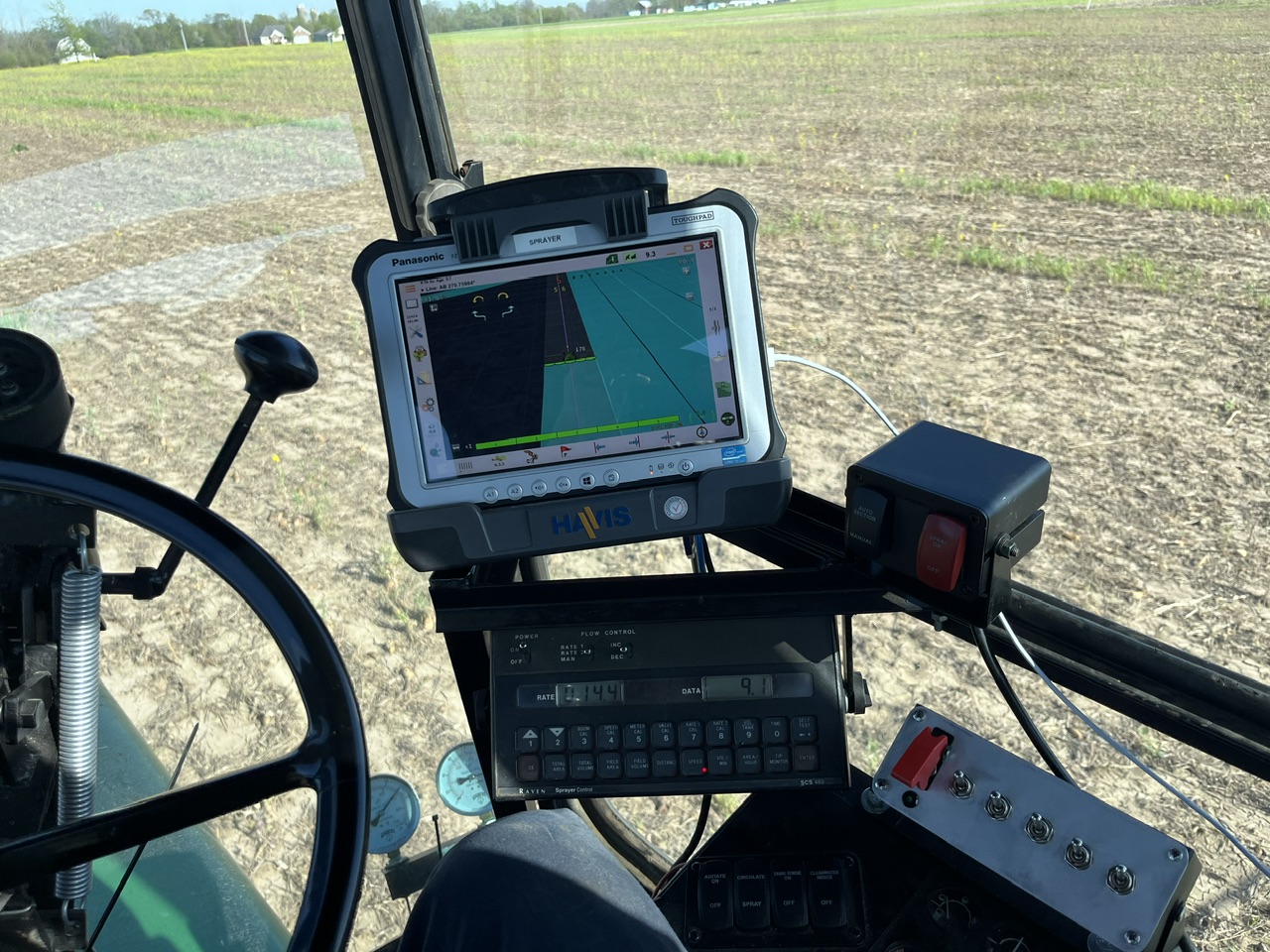

My sprayer runs AgopenGps for steering, mapping and section control. The rate control is handled by a Raven 460. The speed signal for the Raven comes from a GPS speed puck on the roof. The last couple of times I sprayed the speed puck was acting up. I would like to take speed signal from the AIO board. The sprayer currently has an AIO v4.2 std board. Will it work to use the speed pulse + or - pin to input speed into the raven? Will a pull up or pull down resistor be required to clarify the signal for the Raven? A friend has some AIO v4.5 std boards, would there be any reason to upgrade to the v4.5 board as far as the speed pulse output is concerned. Thanks

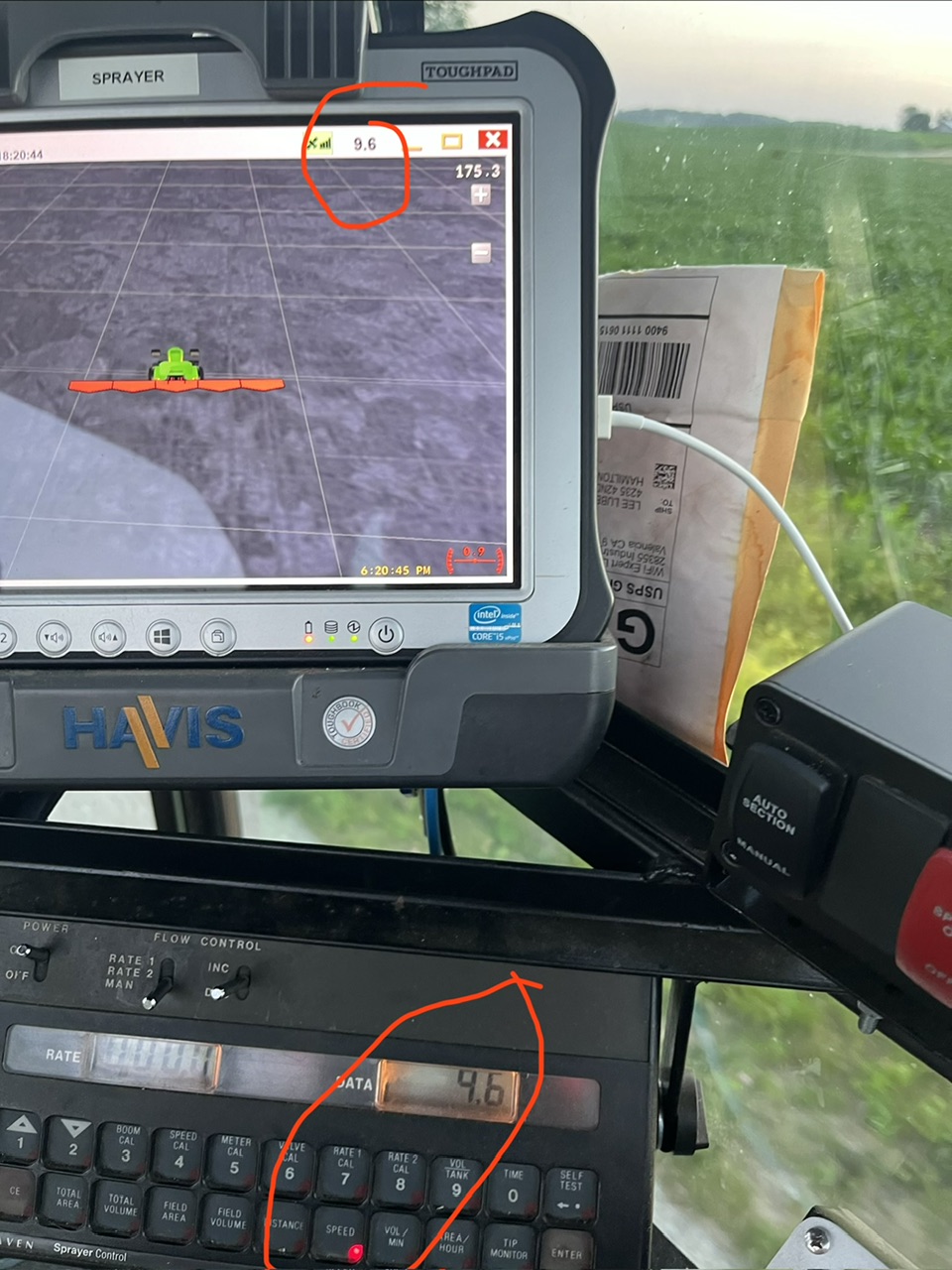

I just had a little time this evening so I tested it as you suggested. Raven signal wire to speed + (pin 14) and Raven ground wire to speed - (pin 15) It worked perfectly. I like that there is less lag now as compared to the gps speed puck.
I am using the v4.2 std AIO board so it does not have the jumpers for the pull up resistors like the new v4.5 AIO board does.
The speed was off, so I cross multiplied and came up with a speed cal number of 610. That got the raven and AgopenGPS in sync. Thanks
