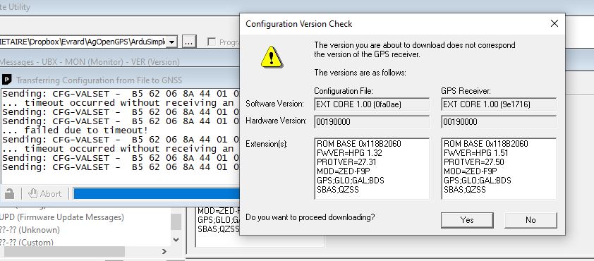

I have a problem,when i’am on U-Center, I am with a system with a single antenna when I load the configuration of the antenna (1.32 SingleAntennaRover) it sends me the message below in photo; so it does not seem to work, but when I load the file (1.32 DualAntennaHeading_RelPos) it does not give me the message, and it seems to work, do you have the solution to this problem?

You are running the wrong firmware. in the screenshot your board has v1.12. you need to upgrade to v1.32. all of these files are in the boards GitHub site. There is a wiki on how to update the firmware as well. Good luck.

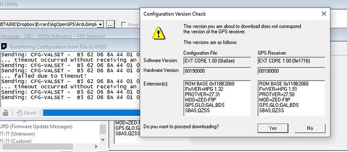

Hello everyone, I have a problem with the panda system, I followed the wiki procedures on github, but I can’t transfer the configuration for a single antenna system, I updated the firmware, in 1.32 (photo 1), I checked that the firmware was updated → it’s good (photo 2), I chose the “1.32 SingleAntennaRover” configuration then I pressed “transfer file → GNSS” (photo 3) and there it doesn’t work, it shows me the next page like what the version I’m trying to download does not correspond to the version of the gps receiver (picture on the previous message), then when I click on “YES”, it puts the red frame to me that there are errors

Ps: when I try with the two antenna configuration, it works

Picture 1
Picture 2
Picture 3

I’ve exactly the same issue. How do you fix it ?
Explanation is in the same discussion !!
It’s because of version difference.
But now, I’m searching a config file for Ver 1.51 !
Why not load the f9p firmware that we know works. I believe 1.32 is the one for single f9p system like yours.
Even though I do still use 1.13 for my single system f9p’s
Thanks for the advise. I’ll do that, because not found any config for more recent version.
