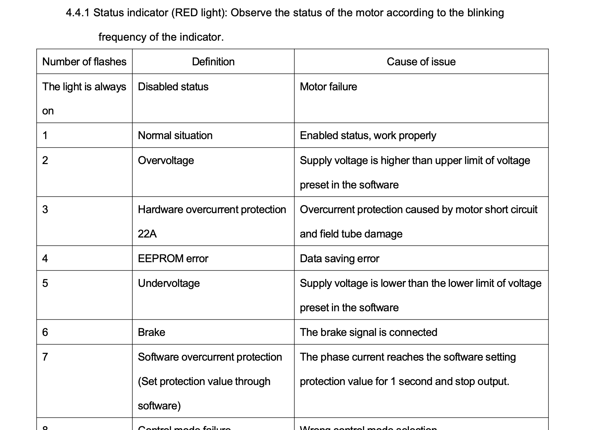

I have tried with the simulator mode but it still isnt working. Im pretty sure it is a v3 but i cant see any indicator lights. it has 12.3v to the keya and all of the wires seem fine. Is there any way i can check that agio is talking to the keya or how i could connect to the keya with the serial cable?
If its the v3 im pretty sure it will have some indicator lights on the motor somewhere, possibly blue lights which blink in a sequence to give an error code of there is a problem. The fact you have no light’s on is possibly a good thing
Did the keya come with a serial cable and a small breakout board? This could be for the v4 versions instead.

The indercator light is red when it is connected to the AIO board and is flashing red when i disconect it from the board with the can wires. Any ideas on what this might mean. I might try contact keya and see if they can help me figure out what is happening i will let you know if they have any ideas. Another question of mine is what motor driver should i have selected in the wizard. I had the cytron selected before when it was working but I am unsure wether this is the right option.
