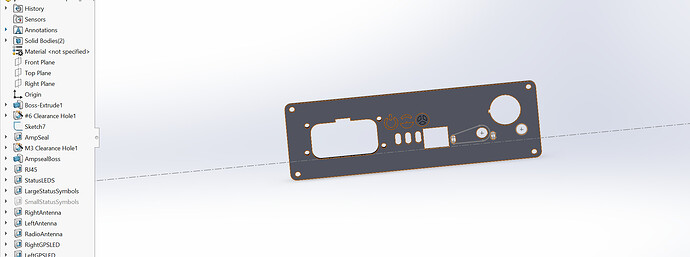

Does anyone have F3D files for the micro enclosure? I’d like to embed some text labels for GPS/Radio antenna and importing the STL files is a big mess
Here’s a solidworks file
HammondFaceplate_v24.zip (298.6 KB)
