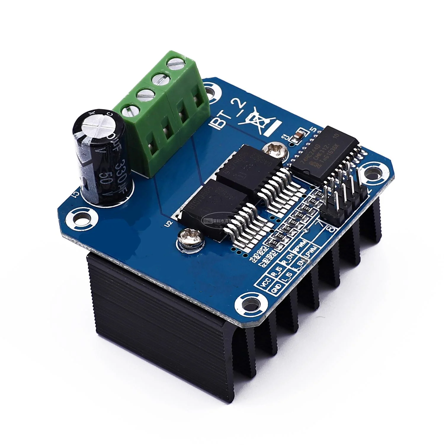

-Motor controller (There are two: IBT2 or Cytron MD13)

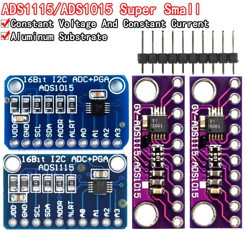

-PCB for autosteer (For beginner use official V2 board or Kapoui, you can find the files in the support folder) with the PCB you also need resistors, capacitors, diodes, arduino nano, ADS 16bit
