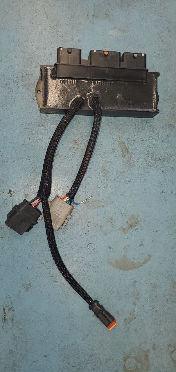

The adapter board is meant to be potted using this tray/box

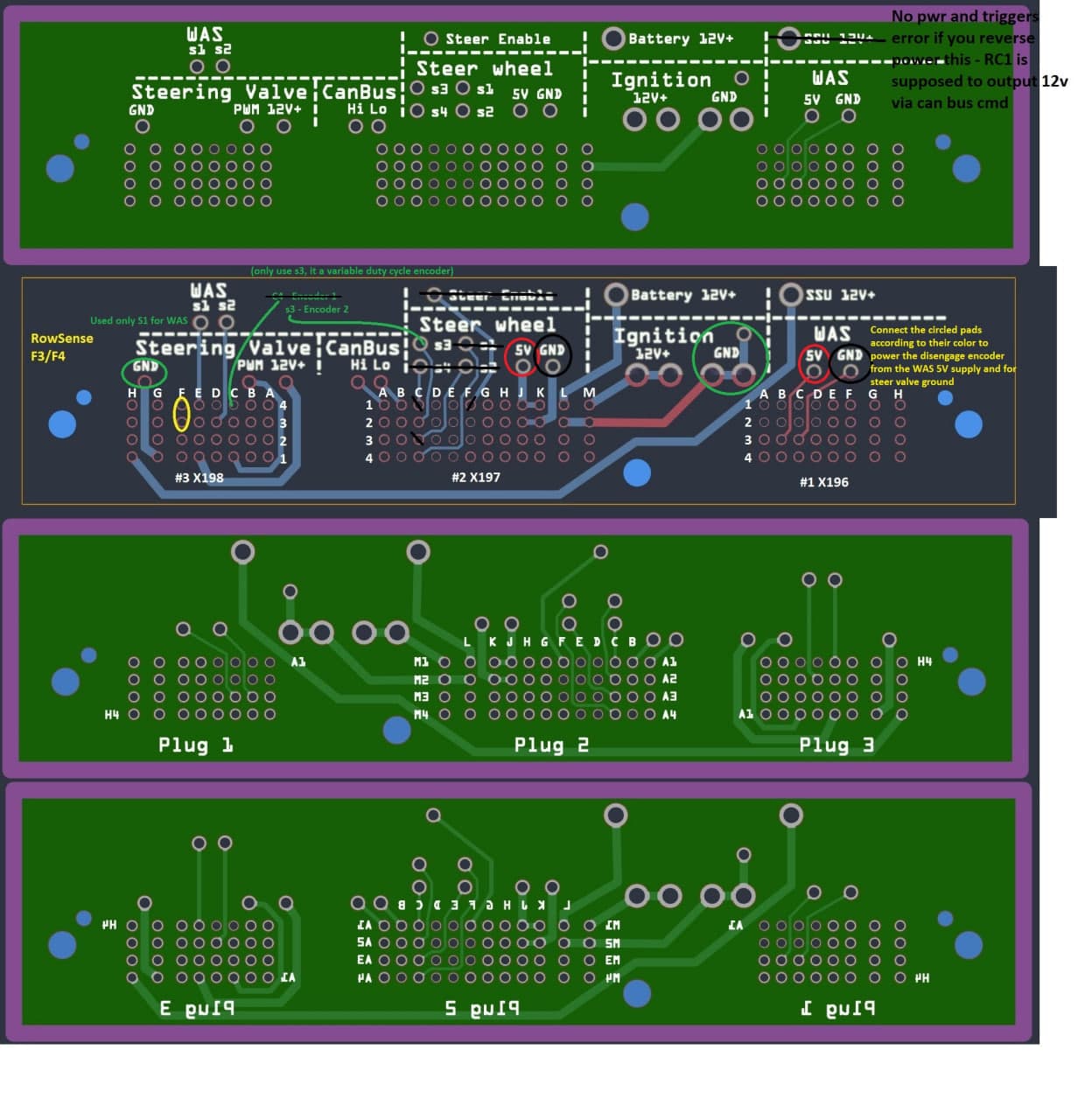

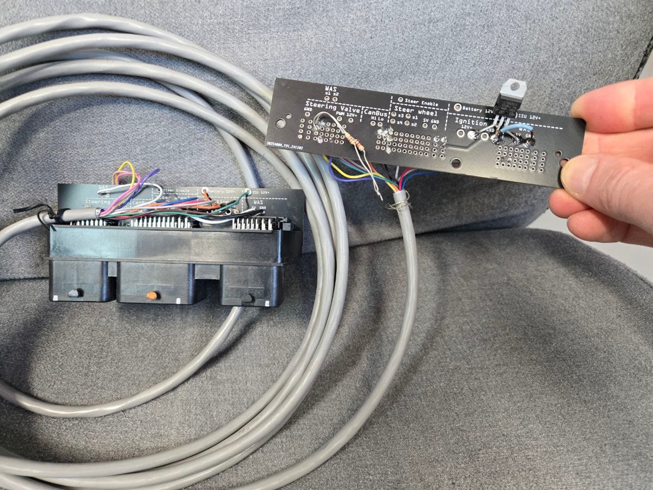

I created a testing harness with two SSU adapter boards. This allowed me to sit in the cab while checking signals with a multimeter. I had to reconfigure the harness a few times until I found the correct pinout for my combine because it’s a hybrid between the 30 Series & R Series.
Here are my pinout modification notes. I was even able to find the corn header row sense signals on the SSU connectors!
