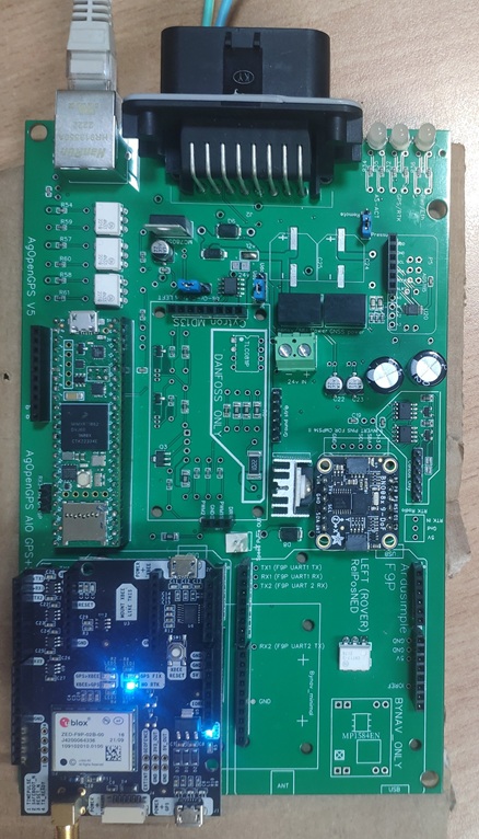

I have an AIO 2.4 PCB (with two CAN buses) and I would like to use it for autosteer on a 2019 Puma case with CAN preinstallation. Can I use this board by loading Commorailsās CANBUS sketch (adapted for AIO) into the tensy?
Can I use one CAN for steering and the other for the armrest button? Because I understand that they are in different CANBUSs.
Yes i believe you can. I also have this board but dont use it for canbus but ive a micro 4.1 that ive used for canbus. I keep thinking i should swap them over and make use of the 2nd can chip on my v2.4 board
The board on the foto does not have 2 can buses i think ? only one
it is a 4.x board ā¦
You can use it, you only need one Canbus for CNH, just connect to Green socket behind seat. Need to be using the most recent Tony AIO Canbus code.
Board in photo has two Canbus chips.
Isnt the engage button on the canbus plug on the right hand pillar and the steering and was on the green plug behjnd the seat. I thought 2 canbus chips was needed for the nh if you wanted to use the joystick engage button
