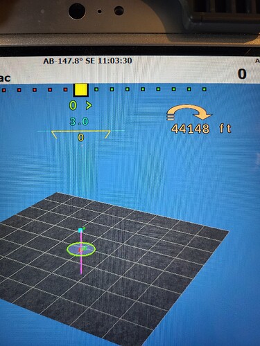

I’m running a self made panda board with teensy 4.1, bno085 and simpleRTK2B. For steering I use a PCBv2 with a simple friction wheel drive. AgOpenGPS version is 5.7.2. Yesterday I noticed that sometimes the lanes either overlap or that there is a gap between them. This only happens occasionally on steep side hills and never on flat land. Unfortunately I didn’t take any screenshot…
I’m wondering if its related to some of the IMU settings:
- Roll filter should be 0, correct? (currently running with 30)
- What is a good value for ‘IMU GPS fusion’ for panda?
- I need to invert my IMU roll in the AgOpenGPS settings. Does this interfere with the panda code?
1- 0 or 1
2- 70% IMU should be a good start
3- should work, just look if the compas tilt in the right direction
Could be the WAS not at 0 / machine/tractor pulling sideways.
wouldn’t this explain the gap if imu was inverted?
Yes that’s the question. What pgn should be sent to teensy when roll is inverted? Not obvious to see in log on ver 5.72.
Or is that info sent to teensy, only if/when you change vehicle?
Here a picture of the gaps (cables are a mess…):
My antenna is positioned on the right side of engine cover (about 40 cm). Maybe this is rather the cause of my gap/overlap issue. I’ll do some further tests with the antenna back in center and flipped IMU (if needed).

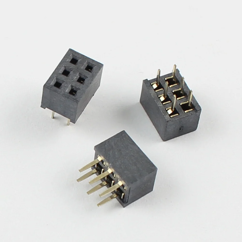

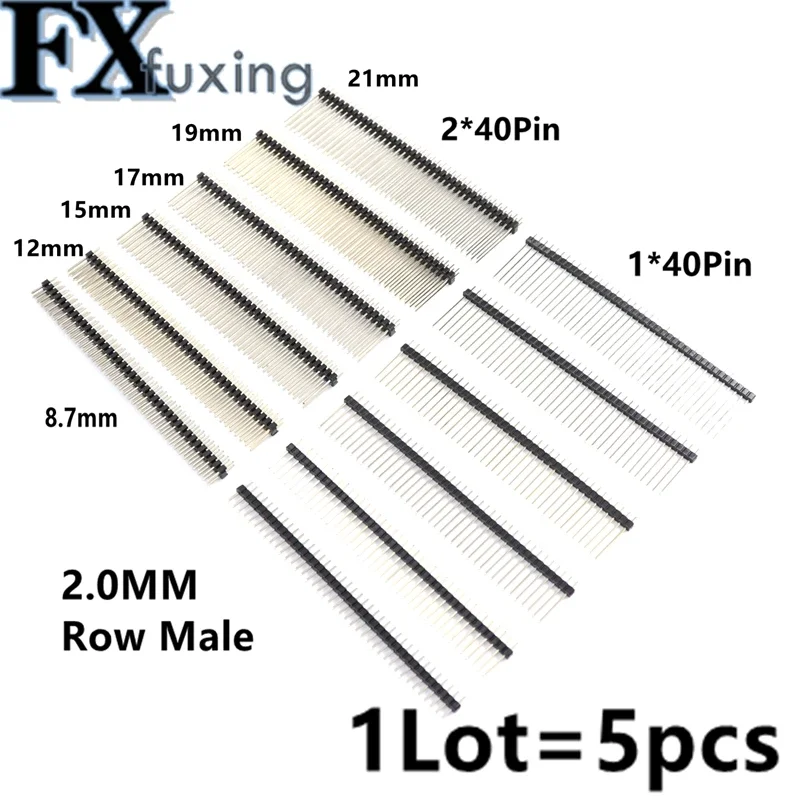

Can someone explain to me how to connect the ethernet pins on the tennsy 4.1 to the panda board. Because I cannot find narrow enough pins to solder.
You can use leftover parts from resistors and diodes. Soldering is both economical and guaranteed.
