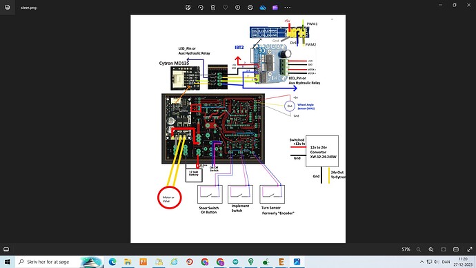

i have forgotten, pressure and current sensor input is moved to pin A0 on arduino. Following highlighted line is in Autosteer_USB_v5.ino
The Kaupoi PCB have the A0 on a pin close to the USB connector of NANO
But you DO use Turn Sensor, which mean you should not use A0 but follow this schematic.
