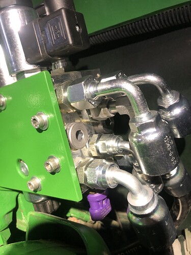

I drove it with the valve plumbed like this for the first time last night, everything works. I can post some pictures later today.

There isn’t a good place to put the valve at the front of a Deere 7x00/7x10, and the orbitol is buried under the muffler. I was able to mount the valve and make all the connections close to the priority valve (middle of SCV stack). You can see the locations of my new P and T lines, and I was able to re-use one of the LS hoses.
It’s 2x 3/8ā€ hoses running to the middle of the tractor and Tee’d in at a convenient spot.

looks good,
question, coming from your orbital pump to barraki valve did you install that line into the lso valve or the lst valve, the diagram seems to show that the line from the orbital should go to the lso valve but then on the diagram the line from the lst port has a label stating to orbitol.
The way raven shows this working is taking the load sense line off of the orbital motor and running that line to the valve on the lspv then from the valve to the orbital motor to the ls steer port on their valve.
Am I correct in that the the line from the tractor that was going to the orbital valve should now go to the lst (line from tractor, not tank) port on the barraki valve and then from the port lso on barraki valve to the ls port on the orbital.
The lst is the one that gives me pause because usually t stands for tank.
Thanks
In fact, the ā€œTā€ may seem like a tank. In this case, the T in the LsT designation comes from the word tractor. So LsO is Ls orbital valve, LsT is Ls tractor
The original load sense connection was priority valve (back of tractor) to short hose to steel line to orbital pump.
The new connection is priority valve (back of tractor) to short hose (re-used) to Baraki LST, Baraki LSO to short hose (new) to steel line to orbital pump.
This is the same as in the diagram I had posted.
The T was returned to a place that Deere approves power beyond return (3pt hitch valve ā€œeasy returnā€). The factory orbital pump returns to the top of the transmission in 2 places and has orifices, I did not want to deal with that and couldn’t find/reach those connections anyway. It seems to be ok.
The mounting bracket is my own triangular plate welded to Baraki’s mounting plate.
Overall I’d definitely do a rear install with Tee’s into steering again, maybe even off the power beyond to make it even easier. Sensing the steering load sense could be done through a steering LS test port.
