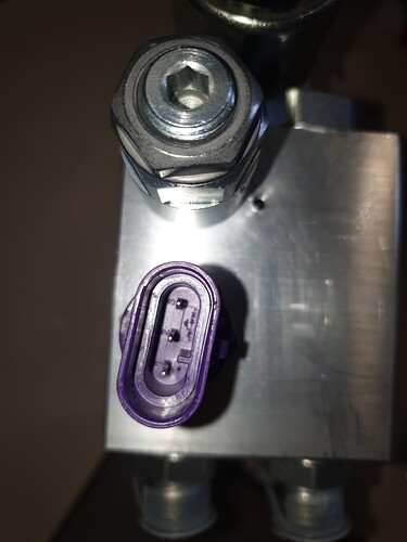

Do you have a picture of the sensor on your OC valve system? (To determine if 3 wire sensor or 2 wire switch)

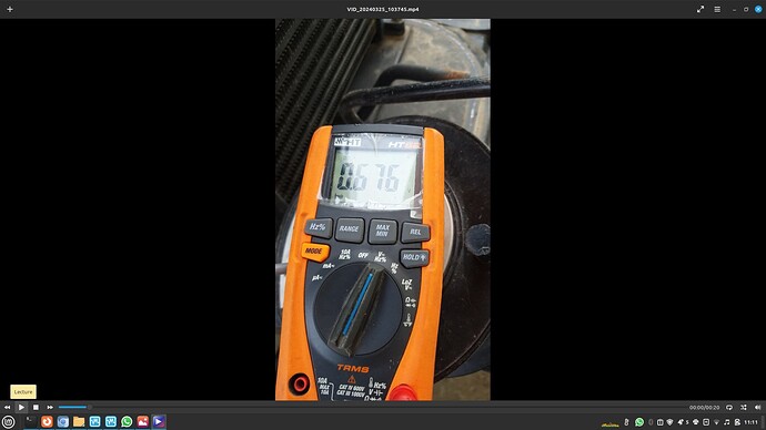

You put the link yourself, so we can assume you have already checked there is 5 v at pin 3 and gnd at pin2. So now you must measure the voltage at the pin 1 and tell if signal voltage change.(with lock valves engaged and trying to turn steering wheel , which obviously should be impossible with lock valves engaged) That way we know if sensor work.
PIN 3 AND PIN 2 = 5V
PIN 1 AND PIN 2 = the voltage values change when I turn the steering wheel
i think that the sensor is OK
on the image below, we can see the following values from agopengps 0% without the âPressureâ jumper, 12% when the autosteer is engaged and 23% when the autosteer is disengaged.
