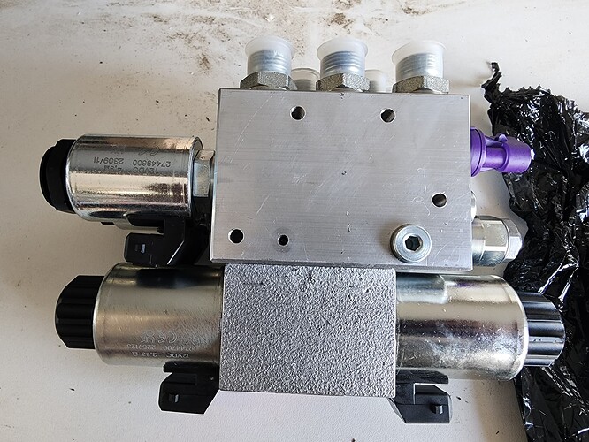

I got this valve 2 days ago it does not not have that port that you are pointing out. Will it work wothout added check valve on fendt?
Did you have a picture of the other side of the valve?
Is that a universal valve ?
