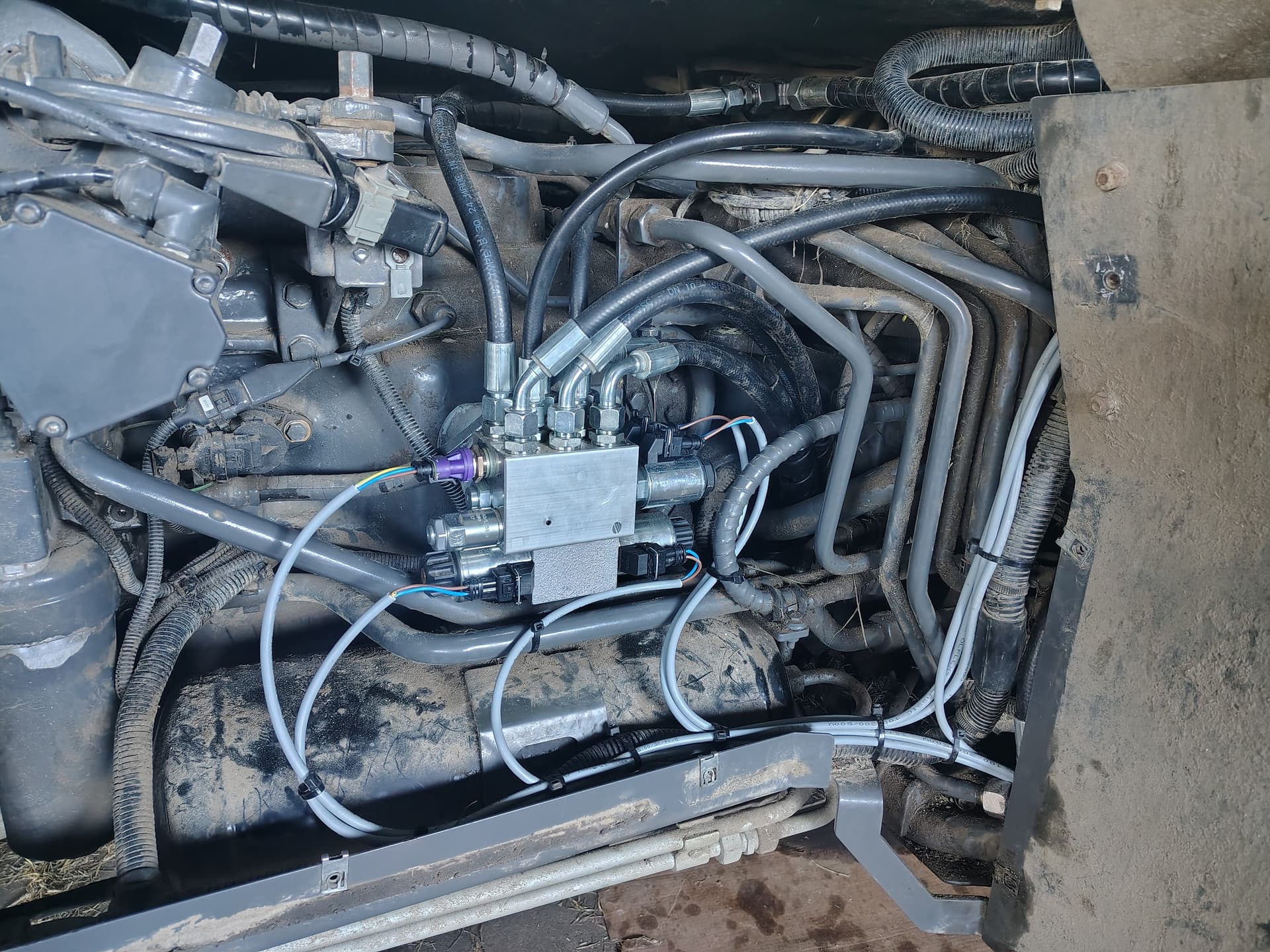

Baraki valve on a Fendt 415. P, LSo and LSt can be taken under the cab near the orbitrol. The T connection is visible in the right lower corner. The steer hoses are connected below the front left side of the cab, where they go from solid pipes to hoses.
I’ve mounted a junction box with relay and schottky diode behind the wheel arch (accessible trough the little hatch)
