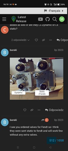

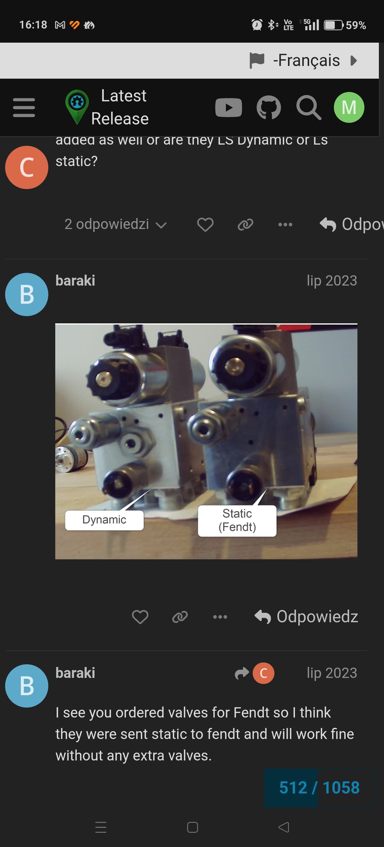

If this photo is up to date and these are the differences between the valves, then I actually have a valve for the LS dynamic
I am not sure about that. I added it externally to the LS valve.
