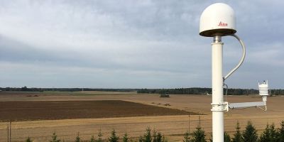

Does not help being close to you if they do not offer the signal for commercial use:
"ESTPOS is widely used by the Land Board and other governmental institutions in Estonia, and for educational and research purposes. ESTPOS is currently not availble for commercial use."
