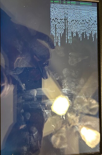

Hi, I am attempting to do my first install with an Orange pi 3 but am running into trouble. I am trying to use the ready to flash installation method. Upon turning the device on I get the following screens.
Check the diagnostic view. Perhaps you could see what happened.
I can’t see the details, but everything seems fine. Now you should open a web browser on another device and connect to the orange pi zero, with http://basegnss.local or http://ip_address_of_your_opi
