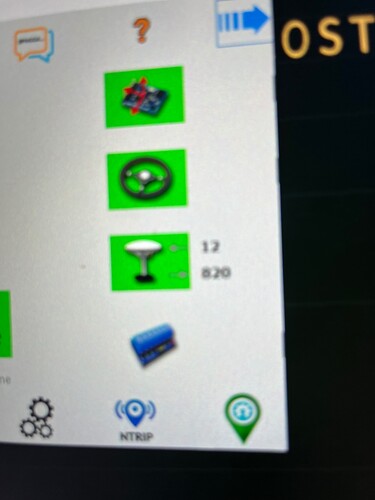

Hello, new to the forum, I installed a base station with an orange pi and f9p (white Survey antenna) and I experienced a problem. I lose RTK from time to time, the base is running and seeing satellites (I installed Tailscale to access it from the field) but my correction through emlid is not getting through.
The numbers in AgIO are not changing it just stays at 12, here is a picture
When I restart the NTRIP A service it works again but stops. Help please
Why are you running it through a third party caster if you have tailscale already installed? Why not just go through RTKbases ntrip caster?

Not the guy you replied to but I tried the Tailscale approach and I couldn’t get as reliable throughput on my Ag Leader display as I could with RTK2Go or Emlid. It would just stop communicating after 5-10 minutes whereas the third parties worked as long as I asked them to.
Idk why but it feels like tailscale would close the VPN connection after my phones (iphone 14) been untouched for X minutes maybe?
Some people stream music to keep their connection active

I’m running it through emlid caster, Tailscale is just to access the rtkbase homepage from my iPhone. Today the base was active all day, no problems. So maybe it was something with emlid server?
Can I access the base with Tailscale through agio?
Yes you can run directly through tailscale, and not use any caster other than the one on the rtkbase server. Short guide here. Just the part for windows/agio. You’ve already got the part for rtkbase done obviously. Tell me if anything with the guide is wrong, and I’ll change it:).
