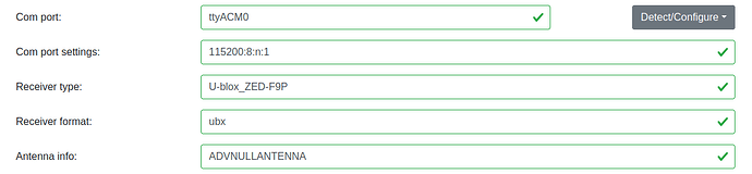

Ok so now my system is messed up. I got the web server to run on Ubuntu, set everything up best I could, but can’t get RTK fix. I can recieve RTCM messages on my phone but they must not contain the necessary information. Anyone have advice?

Which GNSS board are you using?
It’s an F9P

That doesn’t sound right to me. RtkBase should be configuring timemode3 and the base station coordinates for you doing all of this for you in software. Shouldn’t have to do anything directly with the f9p.
That’s what I was thinking. I tried the configure option a couple times. It obviously did re configure the f9 time mode as well as output messages.

Ok so I tried my Ubuntu system here again today. STRSVR was working on my Windows PC so I just unplugged my device and plugged it into my Ubuntu system without changing any settings in the f9p. It started streaming immediately, all looks ok, but no fix. My receiver just sits on DGPS. I have the same messages coming from the stream. Is there some information missing in the RAW data from the f9p?
