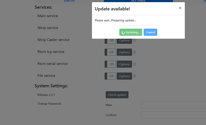

You asked Stefal but surely you are not after instructions to use the “Check update” button at the RTKBase settings page. Can you clarify?
Did you try to cancel and retry? I remember I faced a similar issue recently but the update completed successfully after another attempt. Not sure if I rebooted the base first.

I wanted to update RTKBase, it was 2.5.0, I pressed update and it said that version 2.6.0 is the latest. OK, I accepted, after a few minutes the web page disappeared, and then the software did not start. I tried to idle it for a couple of minutes, but it won’t start. Something?
Best regards !
I had same, had to reinstall rtkbase - gevent hadn’t installed/updated.
Try running
sudo ~/rtkbase/tools/install.sh --dependencies
then
sudo ~/rtkbase/tools/install.sh --rtkbase-requirements
And post any errors
