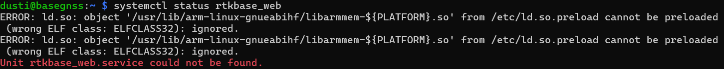

@DLT00 Sounds like the web server isn’t running. What happens when you run
systemctl status rtkbase_web?
It should say something like
● rtkbase_web.service - RTKBase Web Server
     Loaded: loaded (/etc/systemd/system/rtkbase_web.service; enabled; preset: enabled)
     Active: active (running) since Fri 2025-02-14 18:17:07 UTC; 2 weeks 5 days ago
   Main PID: 525 (python)
      Tasks: 2 (limit: 2138)
     Memory: 83.0M
        CPU: 10h 6min 29.700s
     CGroup: /system.slice/rtkbase_web.service
             ├─ 525 /home/basegnss/rtkbase/venv/bin/python /home/basegnss/rtkbase/web_app/server.py
             └─1463 /home/basegnss/rtkbase/venv/bin/python /home/basegnss/rtkbase/web_app/server.py
If line 2 does not say “enabled”, you must run sudo systemctl enable rtkbase_web,
If line 3 does not say “running”, you must run sudo systemctl start rtkbase_web

This is what it returns

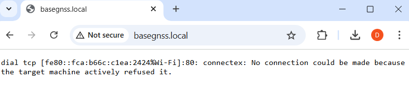

Also when I try to connect to web interface via browser this is what comes up
Everything is down
I did get RTKBase up and running using an old img file 2.4.1 version. I just updated from within the web interface. Also had tried using tailscale and so was getting the wrong ssh name. Thanks all for the help!
