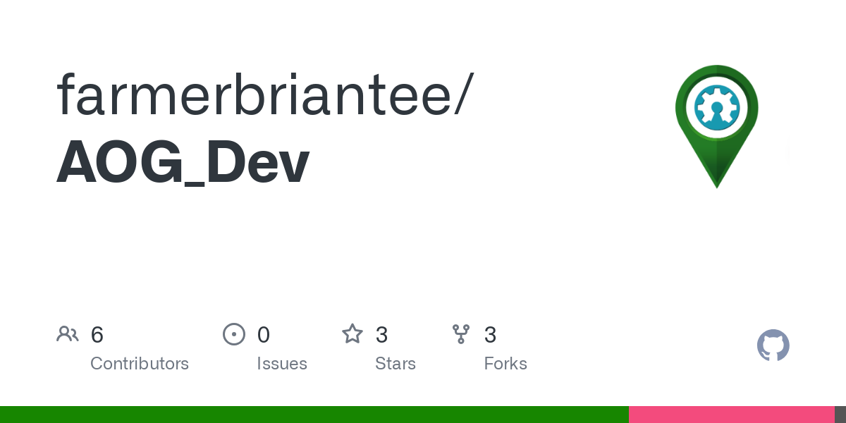

There a complete new software here (I think):
Many features, including toolsteer. But it’s a develop version, expect no support from the community, I don’t think a lot of people use it.
thanks.
May be I’ll have a look into that when I’m more acquanited whith AOG
Not afraid from dev versions, as long as they don’t run on WIN$…
