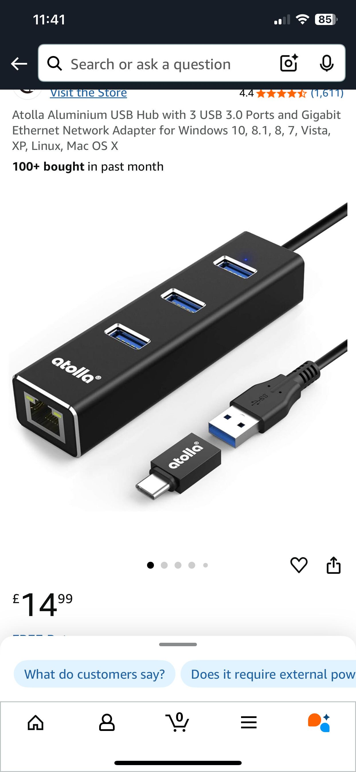

Having only one usb port on my tablet means I will have to use something like this.
Would this work ok, aiming to plug the rtk2b into the usb port and my machine board (and everything that comes after) into the Ethernet?

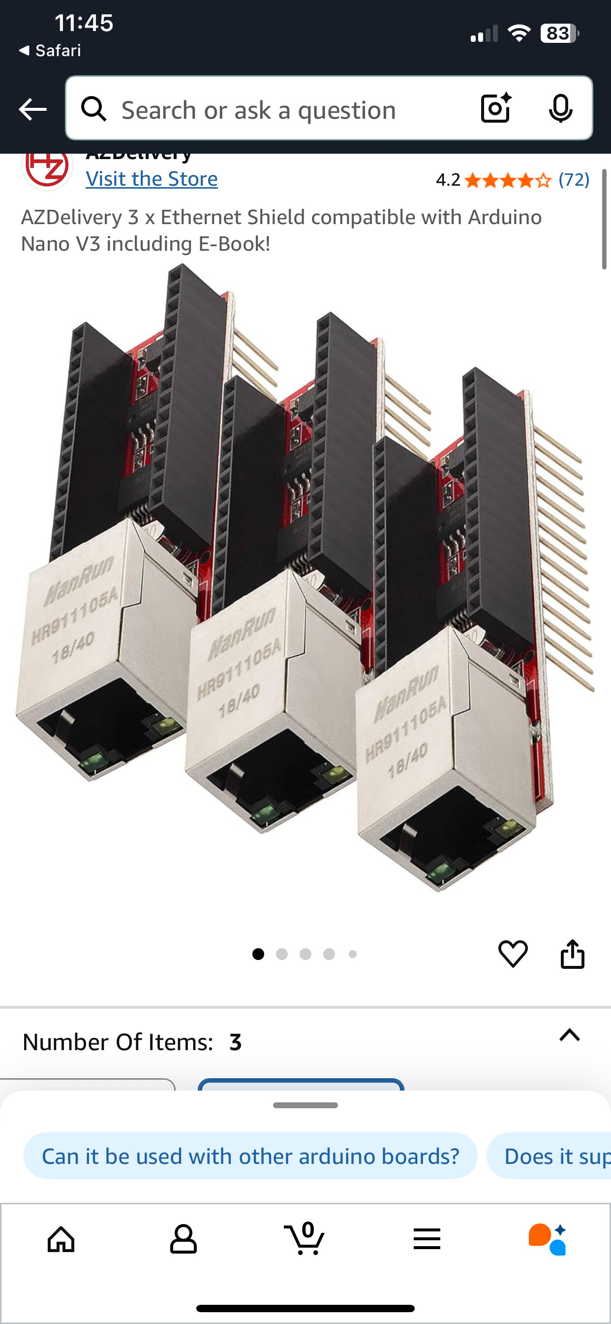

Then this to run the nano? Using 5v from one of the usb ports to power the board?
I got a usb splitter like that running gps, imu and machine module (1 relay) with no issues
Ok looks like a plan then.
Think i will look for one with more ethernet ports and maybe one usb port.
Would keep it open for future projects.

Sure a splitter like that will work. Maybe your problem is how you power your things. Before UDP Brian told to make sure ALL GND was at same spot, meaning: do not power tablet from cigarette lighter plug and PCB direct from battery, because that would mean you have 2 different GND making a little current run through usb connection and thereby ruining the connection.
