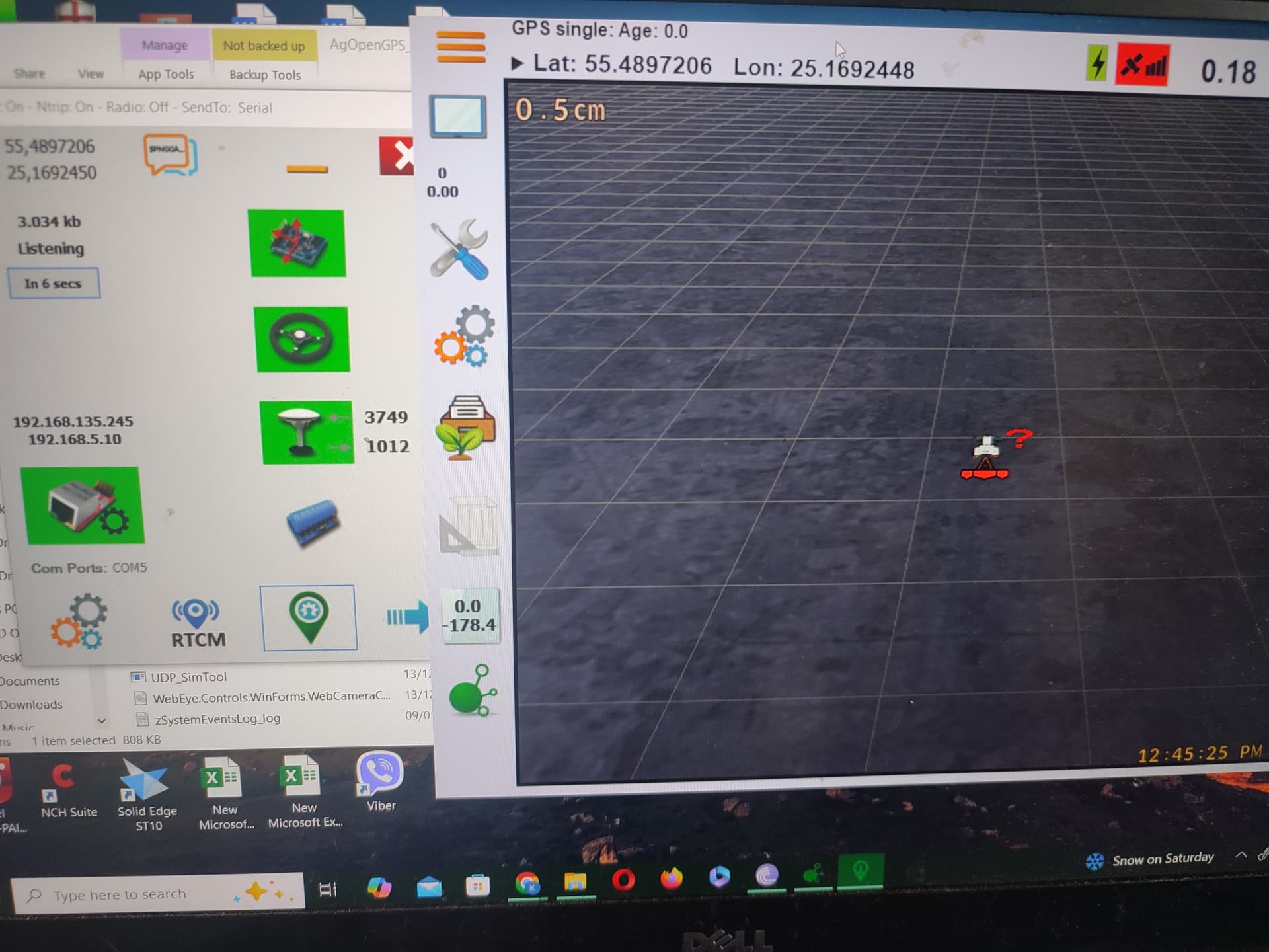

flashed teensy again, and it helped, orange light came up, even those 3 leds came up. now i can connect udp.
Update, after connecting udp needed to put antena outside to catch good signal everything looks good, heading to workshop to work on tractor

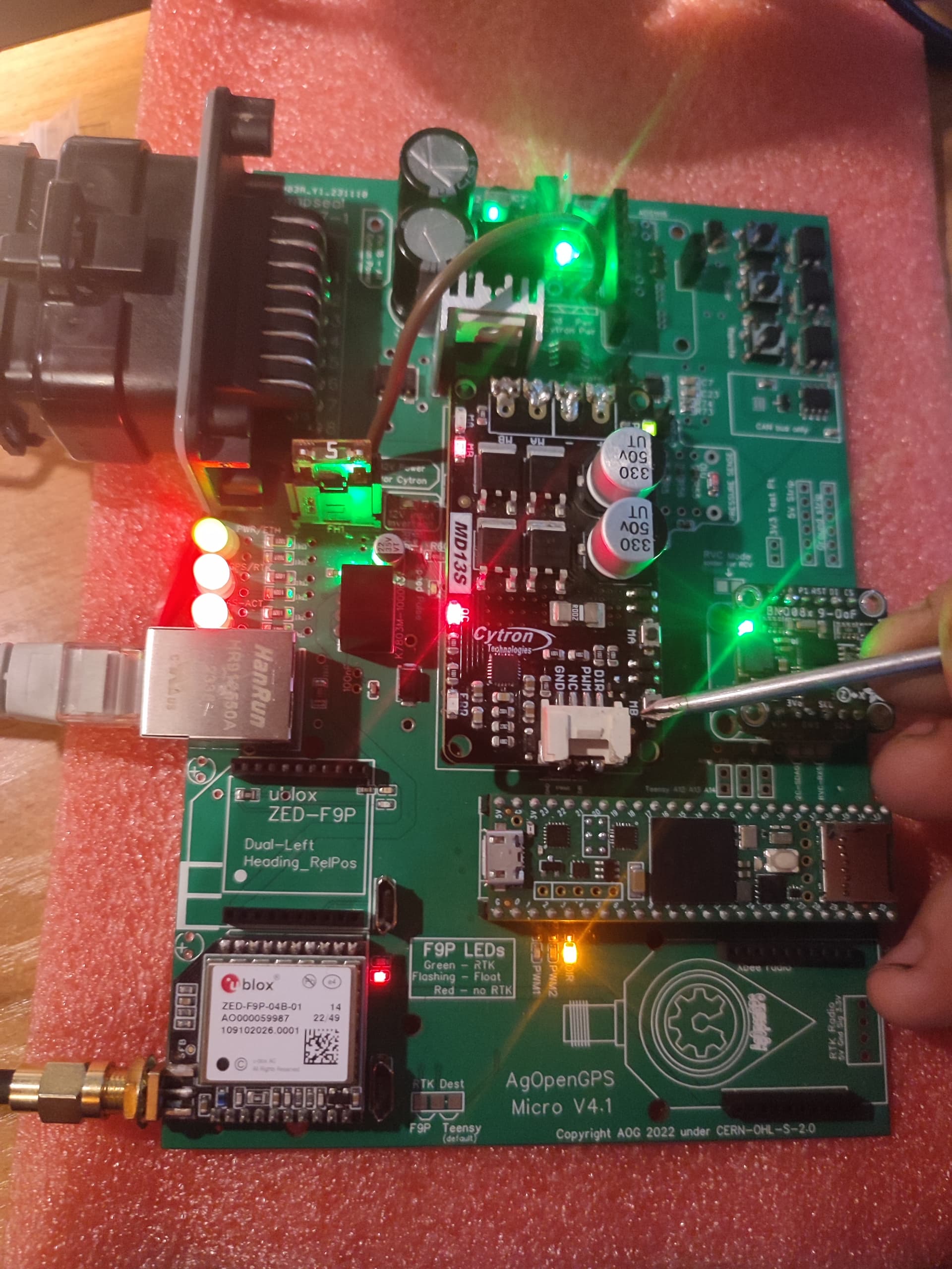

Silly question, with board fully connected except was, by pressing MB or ma on cytron i should be able to spin phidget motor?
No not if you’ve done the freewheel mod to the cytron.
On the steer settings page if you press the expand tab at the bottom are 2 buttons for pwm, try them
No freewheel mod yet, if i press on cytron few leds came up but nothing more happens, checked voltage, when pressed 0.8v comes out of ampseal (5 and 6 pin)
Nothing happens using app
Cytron should have green light on not red
it has, power has green, when pressed 0C and ma/mb lights up red.
to me it looks like cytron power and mb/ma also main pwr/eth leds are kinda blury comparing to others
It looks like your overcurrent indication light lids red ! (So the motor takes too much power)
same thing happens with motor disconected.
If you press ma / mb and the OC Led indicates an overload current, check your output wiring.
What’s that jumper wire you put in doing?
Ive got one from the next terminal over on mine (pin 18) to cytron power :thinking:
Also is the orange dir light meant to be on? Ive not noticed on mine when testing
dont know about dir, but now i managed to make ir work by ma/mb buttons, but it dosnt work through app.
do i need to do something about was?
