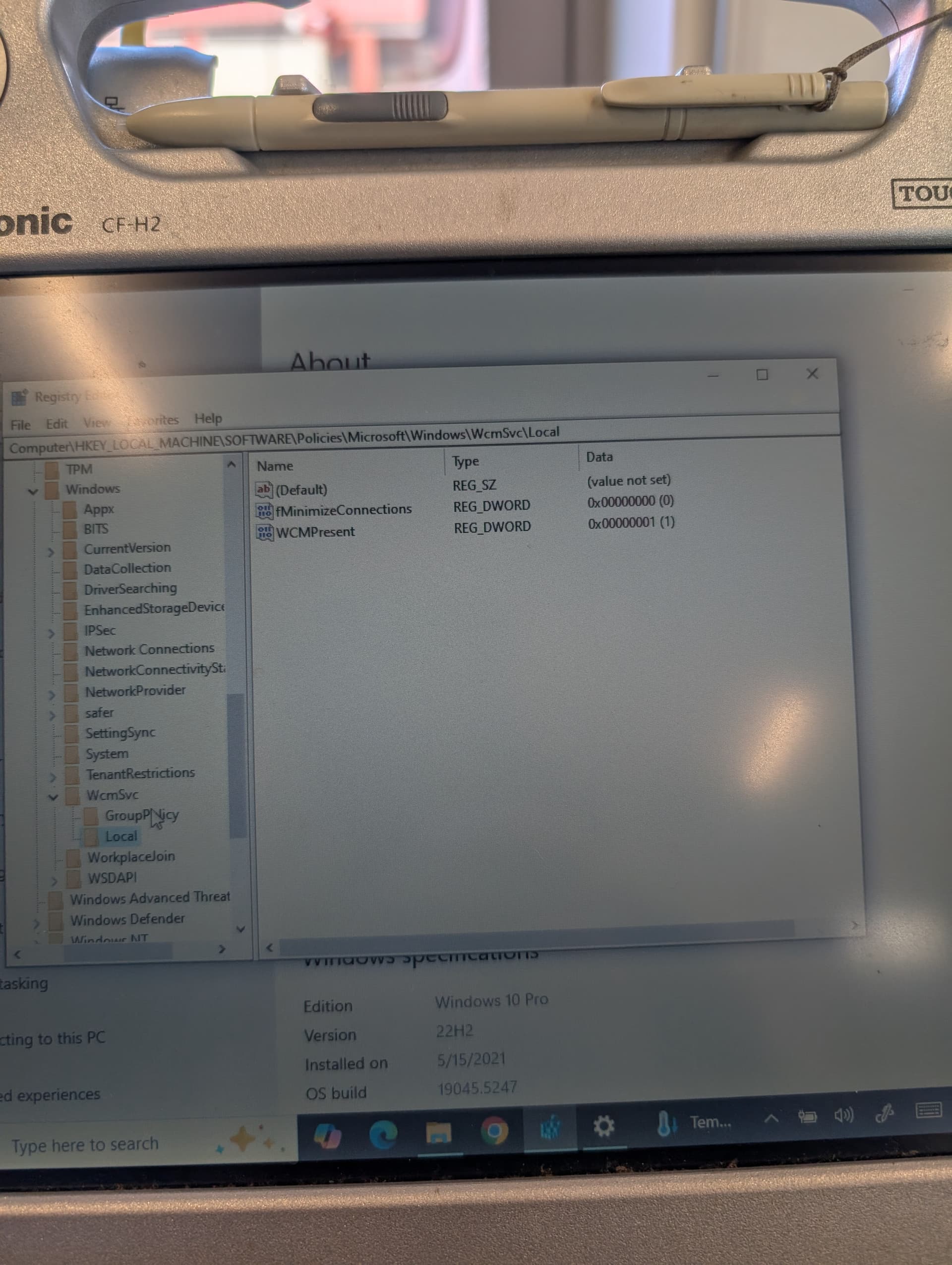

I have just set up my all in one pcb and I’m testing it on a toughbook CF-H2. I have it connected via ethernet, but the computer won’t allow wifi now. I went through the fixes in this website (How To Use WiFi And Ethernet At Same Time In Windows 11/10) and the fix at Boards/Misc/Network-Drop-Fix.reg at main · AgOpenGPS-Official/Boards · GitHub. Neither of these two methods allowed my to access wifi. Is there another way to prioritize wifi over ethernet on Windows 10, version 22H2?
I had a similar problem, to enable LAN-Ethernet & SIM Card together
How To Use WiFi And Ethernet At Same Time In Windows 10 (kapilarya.com)
I think, I did Method 2 – Using Group Policy
