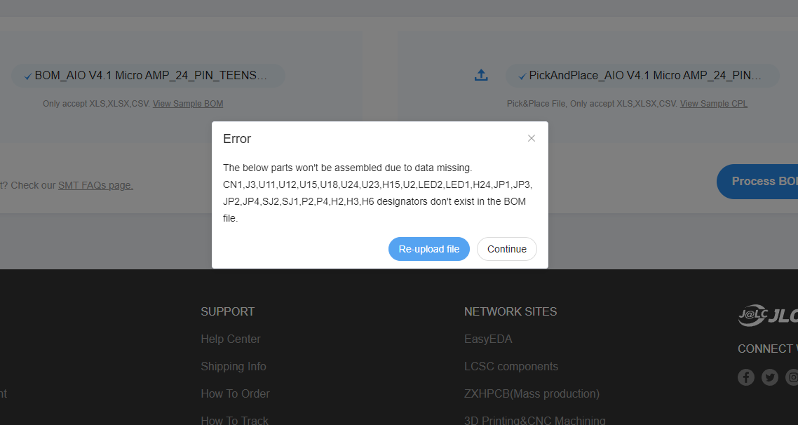

I am trying to order the AOI board from JLCPCB but i keep getting this error pop-up (see picture). Does this mean that it doesn’t work or can I proceed anyway? Thanks in advance!

I have the same error:
“The below parts won’t be assembled due to data missing.
CN1,J3,U11,U12,U15,U18,U24,U23,H15,U2,LED2,LED1,H24,JP1,JP3,JP2,JP4,SJ2,SJ1,P2,P4,H2,H3,H6 designators don’t exist in the BOM file”

There was an answer here:
That would be normal.
